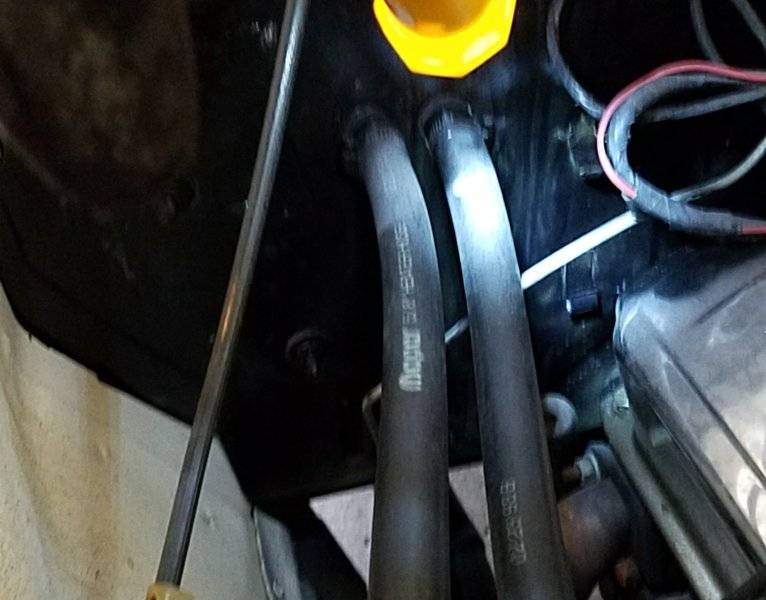

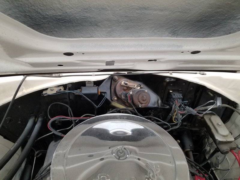

I can't even find the blower motor! is it behind the glove box?! There's nothing on the firewall except what i believe is the wiper motor
Not seeing the motor
You have to drop the heater box to find the blower motor but that should be your last resort. No need to get near the motor for any tests. That little dimple in the firewall is where the blower motor is.
