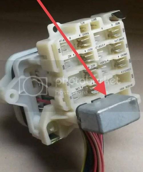

I’ve looked everywhere and studied photos on the web. 1971 Dodge Charger I assume. Some internal item.
Horn relay door buzzer combo in 71.
Also horn relay/door buzzer in 73 74 chargers
As mentioned 71/73 buzzer and horn relay… but NOT DOOR buzzer, actually KEY IN BUZZER which buzzs when driver’s door (just driver’s door) is open and key is in, to warn about close the door locked with keys inside.
on 74 just horn relay… the buzzer was removed from horn relay assembly and moved to another location driven by the interlock control box.
