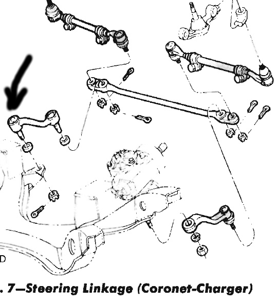

Is that what you took off of it. Been awhile but iirc, there should be a thru bolt to mount the idler to the K frame.....
Whoops! My bad!!! I'm sure that your k frame is not original to your car as that style of idler wasn't used after 65. The 66 and up went to a thru bolt design, double shear on the idler.
