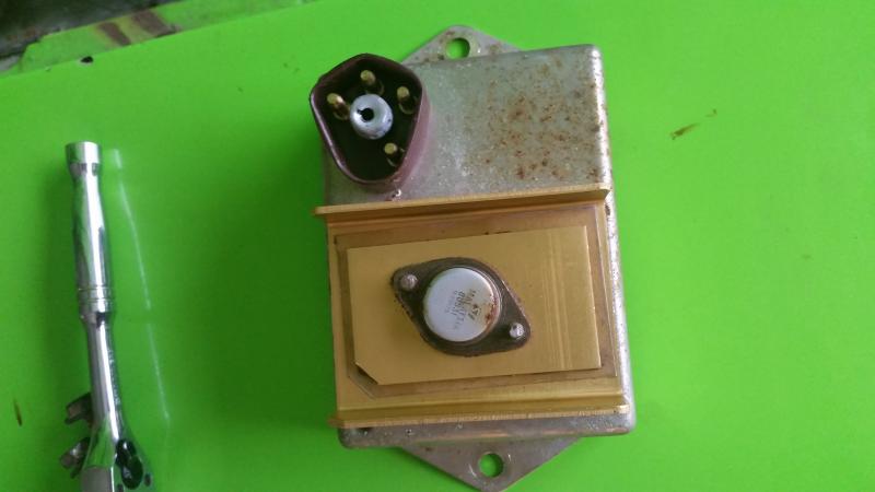

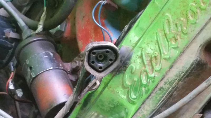

Does this make a difference.. no spark cranks like hell
Do you have the 5 wire, dual ballast resistor and the 4 pin ecu? My understanding is you can use the 4 pin ecu with either the 4 or 5 wire connector. And not to use the 5 pin ecu with the 4 wire connector. Might be easier to check out some simple wiring diagrams online to check for voltages and check the pickup. If they check out, the ecu is bad.
Thats fine as all the newer ECU boxes for our Mopars are 4 wire as it just does not use the 5th wire any more as it was juat and extra 12 volt key on feed that went thru the 5 ohm ballast to turn on some ECU components. They eliminated it as the ECU already had a 12 volt key on feed and they just used that to turn it on in all the later ones. That dont mean yours cant go bad but it will work fine in that setup. Ron

Well got the motor to run and she sounds good.. problem was well embarrassing.. my dad and I did not take the car a part so we went off the other guys duct tape labels on the wires... turns out the - coil wire was not hooked up we had the tack hook up like it should be... well put the other wire I found labeled some kinda critic writing bull **** and bang ran like a champ after a little timing set..... lesson learned haha.....
