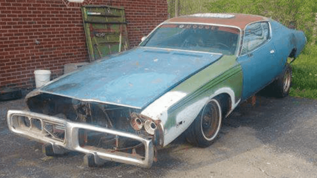

I've picked up a 72 charger that I have been dying to have for a long time. This is my first moose car so even though I have a general idea, I'd like more knowledge and explanation in the mopar world. My car has the 318 backed with a 904 trans and 8 1/4 rear end. However I would like to do a 727 or a manual good for the drag strip and Ford 9" swap. But the biggest question is not 440 or 426, I'm more curious as to what is the fastest I can make the 318 go? Blown 390, maybe even 416... nitrous?? i want to really do something different for around here where I'm from than the common mopar hemi engines and big blocks. Thanks in advance!
