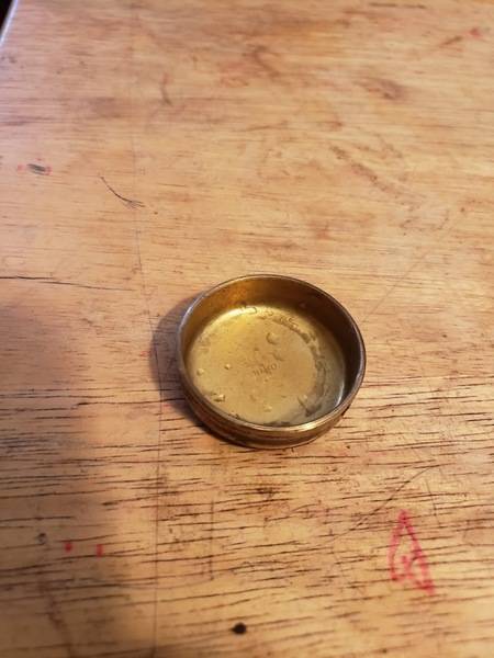

Working on the car, have it running and Boom..
This little Bastard decides to jump ship!!
Luckily it is on the Passenger rear side of the block!
Sorry to hear about your dad. That looks like the typical Chevy freeze plug which is what you get in the freeze plug kits, 1 5/8". Mopar is 1 41/64" which is just a little bigger and a shallower cup.

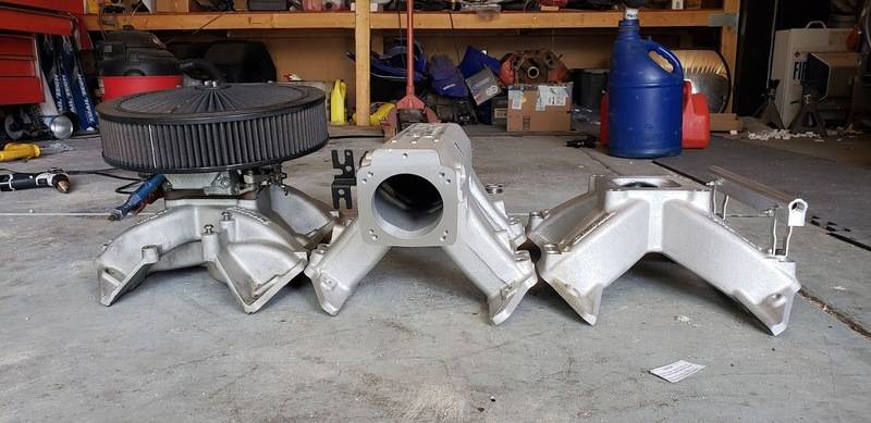

I am a manifold Hoarder.. I have a problem.
dGCjl2SOCem2ABTLb8mB2lNHAEOFY3SXRj-hOK58T9XeGOUicH3XDxZdDD_jp8u_tOGTGzxanQy_pxS84A=w1364-h663-no.jpg
I was planning on doing what you did, until I saw the price of Pro-Flo 4 and seeing and hearing Dennis H's car running with it..
