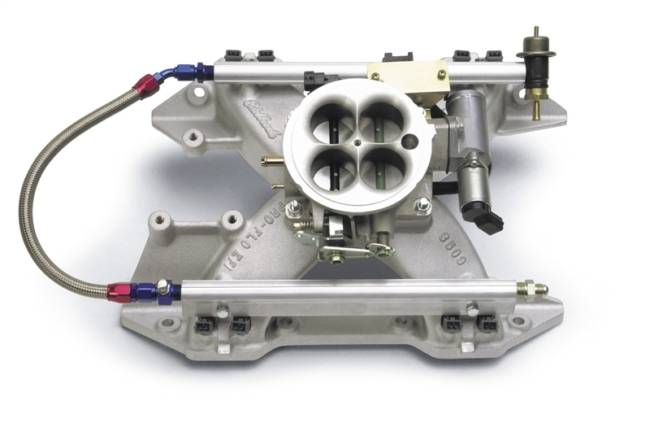

The Pro-Flo 4's price is tough to beat...you get MPFI vs TBI and the distributor included. I gave Holley time and expected they'd have had an answer by now...not the case. If you are going with fuel injection, MPFI > TBI all day, every day. The only downside, if aesthetics matter, is that it is harder to conceal. Couple the fact I might eventually run a ProCharger and the XT option made even more sense.

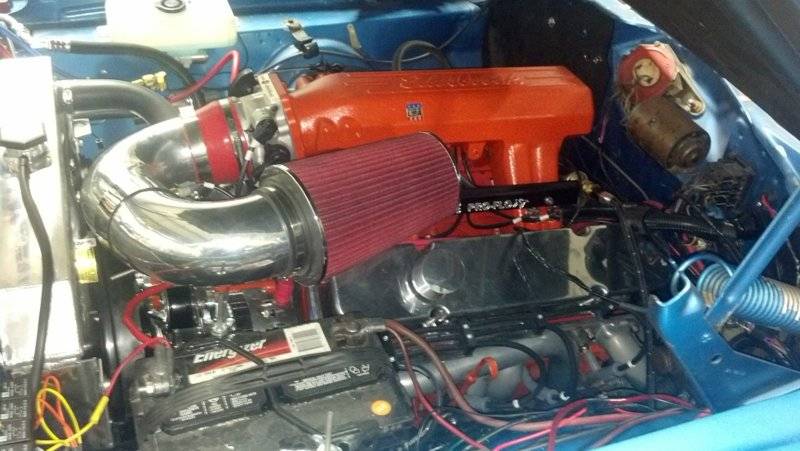

Intakehoses.com has a 90 degree 4.25 to 4" hose.
Silicone Reducing Elbow 90 degree 4.25" to 4" ID Short Radius - Gloss Black
R90B-400-425SR
Kind of pricey, but solves the air intake issue when used with a Dorman 902-3022 90 degree thermostat housing.
Just a recommendation.

I know, it looks like a mess right now. One of the reasons to re-wire the entire car.
I found the TB to spectre 4" tubing on E-Bay. I see more listed now than when I was doing this about 5-years ago.
There was a guy with a green mopar on the Edelbrock support pages that helped some. Told me about the Lokar cables and stuff like that.
I may have swapped my fuel rails around to put the regulator on the drivers side.
I would like to make a custom intake out of fiberglass, that covers the top of the intake and put a stock type oval filter and cover on it.
Having the air go down the sides if the intake and into the throttle body.

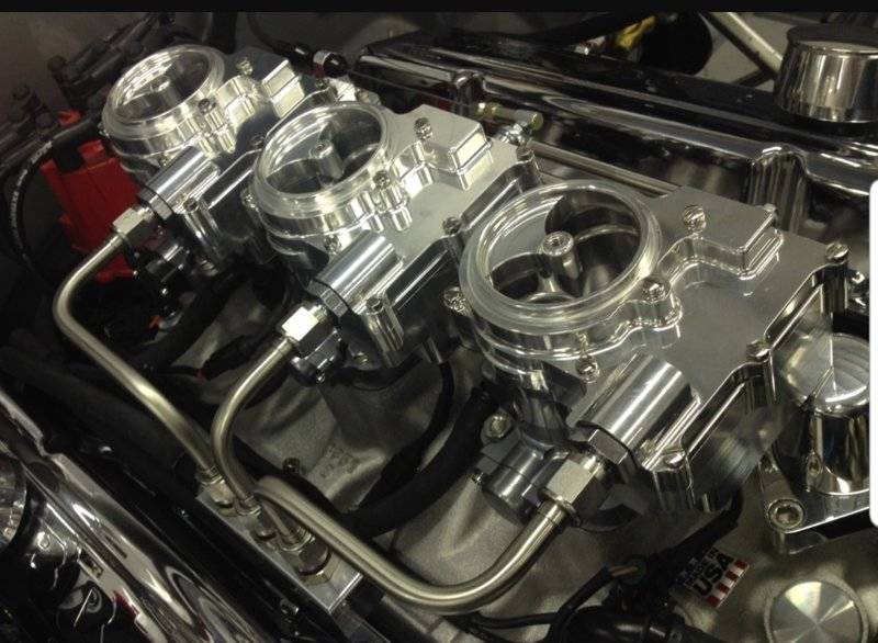

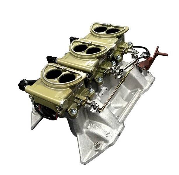

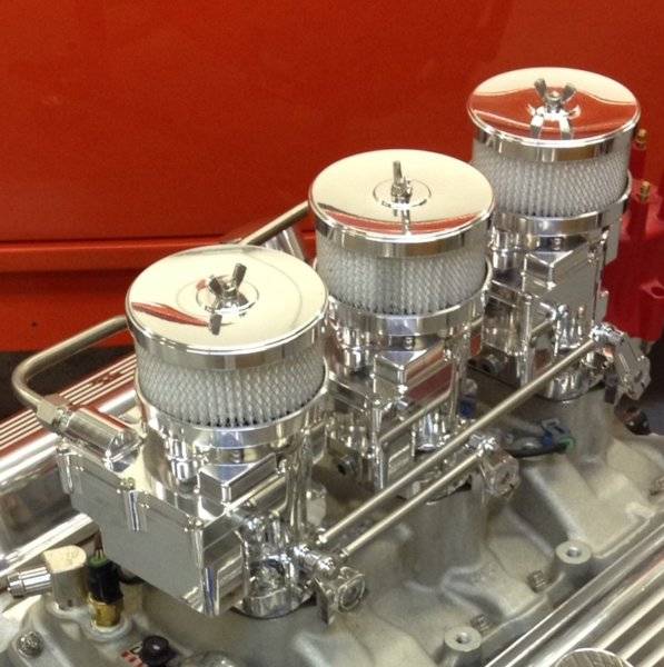

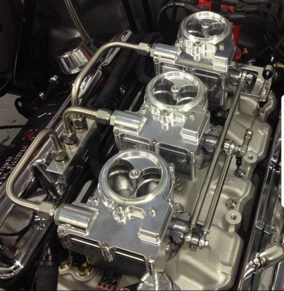

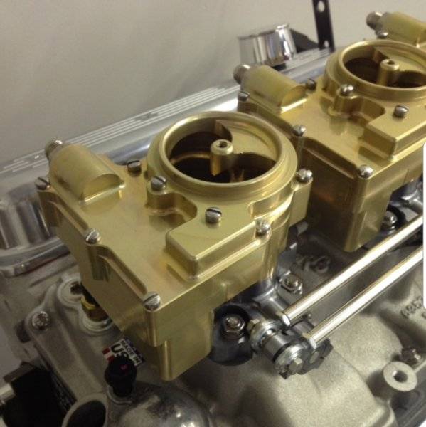

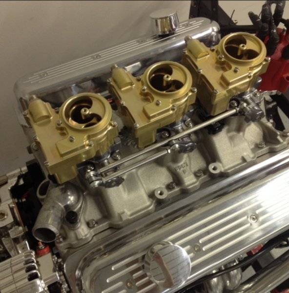

There are 6 2bbl carbs, 2 engines, 2 classic muscle cars, and one wife who I don't want to have problems with because of problems she may have driving her car, and confidence in knowing that we are not leaving a lot of performance "on the table" especially regarding the 421 in her GTO.
All of those factors come into my EFI considerations.
BOTH cars will ALWAYS have 3x2 of something atop the engines, unless she surprises me regarding the 421. My V-code definitely will have a 3x2 setup, always.
First, my "equation":
With the current build level, and even if I just added TrickFlow heads (which I AM going to do) the FiTech 3x2 TBI EFI system and its associated 600 HP limit would work great. The problems with doing that are I definitely want to build a 600 HP 650 Torque stroker motor, and at that point, I think the FiTech would be holding me back. The other factor is my 3 Holley 2bbl carbs are in great shape and fully modded with Promax parts, so with tuning and the associated jets, power valves, etc, and the center carb Promax metering block, I am definitely good to go to make the power I have set as my goal with these carbs on my future stroker motor, as well as now and along the way.
So while the FiTech may be fine now, in the future not so much.
The "equation" for the built 421 in the GTO is like this: With the performance modifications done to it before we bought it and with the additional upgrades done when I had it rebuilt a few years ago, along with the suspension and rear axle mods done, her goal of running quicker than 12.8 in a quarter mile should have already been met, but it's not that fast, and traction is not the problem. So that and other factors point directly to the 3 Rochester 2bbl carbs. Now other than the possibility of adding aluminum heads to it down the road to replace the already ported, good to begin with iron heads on it, I don't see any other mods being done to the 421. That means that the FiTech 3x2 system would be ideal for the 421 because I believe that not only would that assure me that we were getting our maximum performance return on investment, but it would also mean a much more reliable experience when my wife drives her car, and the 600 HP limit of the FiTech is well above the output capability of the engine. The plan is to have a Pontiac Tripower guru rework the 3 Rochesters to make them compatible with the build level of the engine, because their current stock form, although they are in pristine condition, leaves a lot of power untapped. Should they still leave us or her wanting for more, at that point I would suspect reliability would be the only possible remaining issue, well then I am ready to change over to EFI. While the FiTech 3x2 system is plenty capable to do that job well, unfortunately there is an $8,000 EFI system (including fuel pump, lines, etc) that looks almost exactly like 3 2bbl Rochesters, and naturally that is going to be what she wants, and that's hard for me to argue against because DAMN! they really do look that good and perform exceptionally well too.

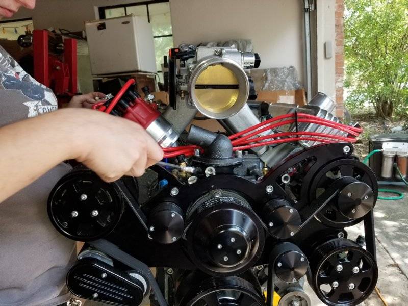

Another question, have you started working on the intake plumbing yet? Just curious how you handled that. Thank you for documenting this install for those of us coming along behind you.
Not yet... Running all the possibilities through my head.. Right now floating 4 inch T into 3 inch and have 2 3 inch pipes coming out and down
