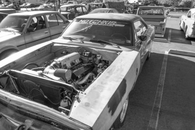

        Wanted to update.. I have been taking the car on longer and longer drives and it just runs better and better every time.. No fuel pump issues yet.

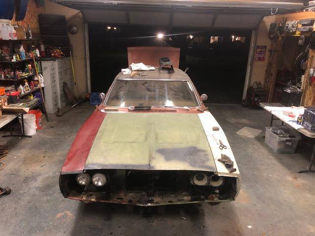

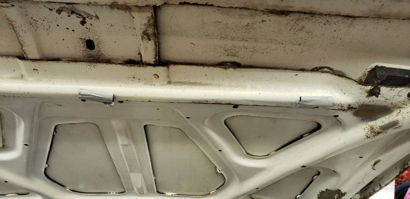

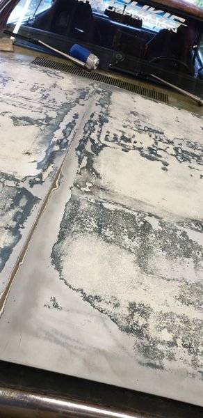

            So latest update... I need a rework.. I tried installing the hood and it won't close..

            I have a few more tricks to try, but not cutting steel hood.. There is a company in Chicago that makes a fiberglass bolt on hood.

              Fiberglass Hood Ordered, along with new Hood Hinges.

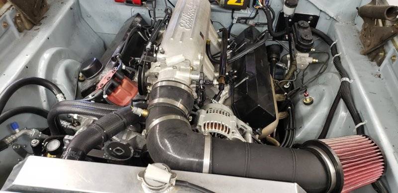

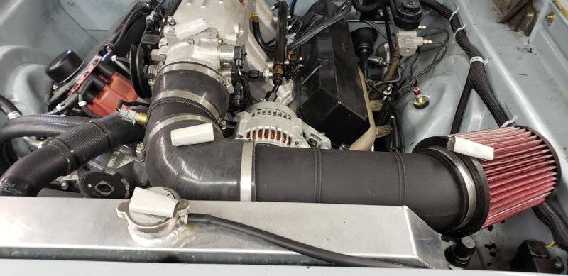

              Cool Shot of Engine

                  Did the stock hood not fit?
                  I have a stock flat hood from my Coronet 500 on my Convertible and it fits, but we did cut a hole for a six pack scoop when the engine had the RPM intake and Holly carb. Maybe just the center rib is hitting?
                  Edit: Just looked at the photo, looks like stock hood is hitting the front rib? My intake tube drops down further than in the front. That may be the difference?

                  Yeah my Accessory drive is in the way.. They are making the hood without that forward Rib, so I should be good.
