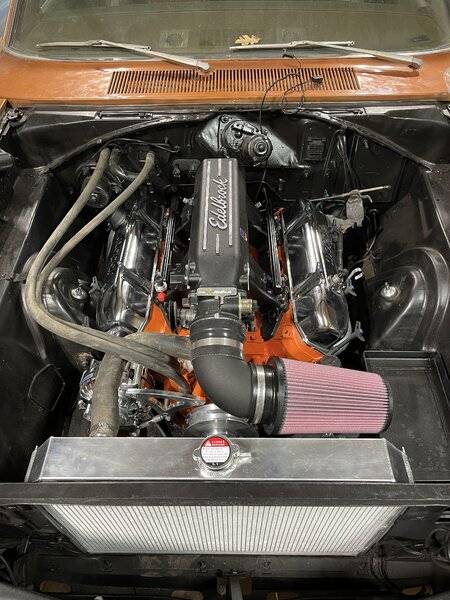

Installing an Edelbrock PRO- FLO 4 XT on a 440 (Lets open the Box)

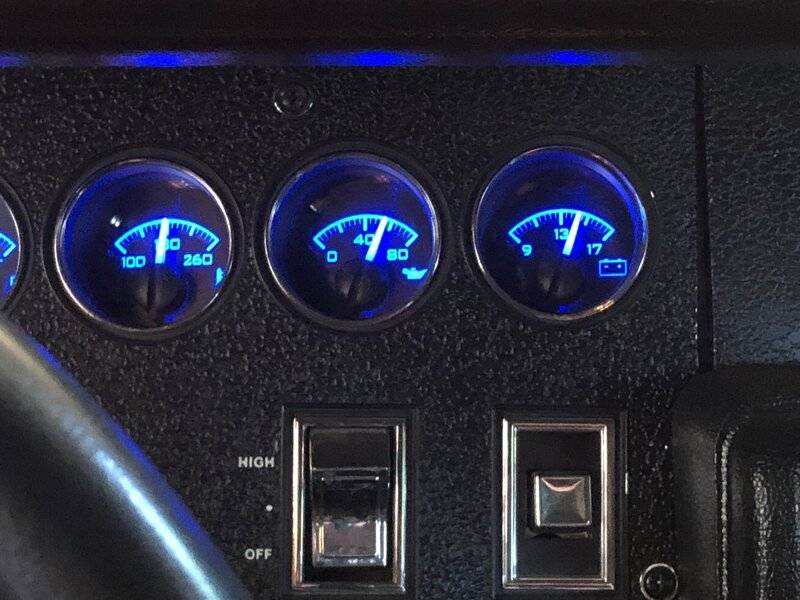

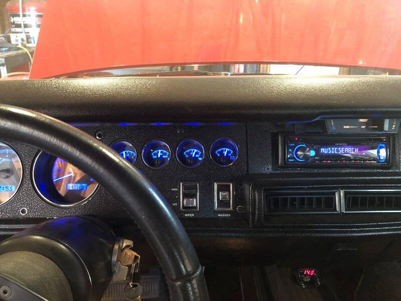

Looks like a Dakota Digital gauge panel.
Other than the gauges, what info are you using the LCD data panels to display?
Digital display of Speed, I have to play with it more.. I also have the Data connector for the Edelbrock Pro Flo 4 so I pull coolant temp from that.
I am considering trying the small left and right mirror image LCD displays to show my A/F ratio from my Innovate Motorsports dual wideband O2 sensor system. Also looking to see if the 5v trigger that can be activated as a "warning" can light up a stand alone LED shift light, otherwise I'll have to use a 5v triggered relay, Dakota Digital triggers the relay to power on the shift light.
Originally I bought it just because the gauges are so much easier to see at night, but since I've had mine for so long, waiting to get it installed, I've learned about more of what its capabilities are, and they are pretty impressive!

Looks like the voltmeter was showing a low number.
Dakota Digital, right?

:thumbsup: Dakota Digital :bananadance:
Looks great! I got the same gauge set but with red backlighting. The blue backlight is beautiful and pleasant to see, but I chose the red so as to not affect my night vision.

Pretty cool how EFI has become accepted... Systems that can handle the cams we run & actually make them seem pretty tame, twist the key stone cold & it'll start and idle... Takes off & acts like a normal daily driver while still able to make power.... Kinda nice...
Getting close to starting my 69 pro flo. Need some help on getting located cables bracketed right to tie into foot feed and kick down. Can you help?
I would give a call to LOKAR.. I am running a manual trans so I was able to just run a throttle cable.. You might also want to look at replacing or Modifying the Gas pedal for more throw.. I don't think I am getting full throttle..
When you installed your ProFlo XT4 manifold, what did you use for a valley cover set up and gaskets please
