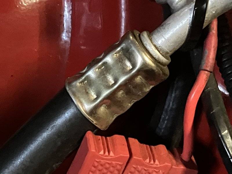

Did my system quit working because of bad crimps?
Could it be a loose fitting? Bad O-ring somewhere?

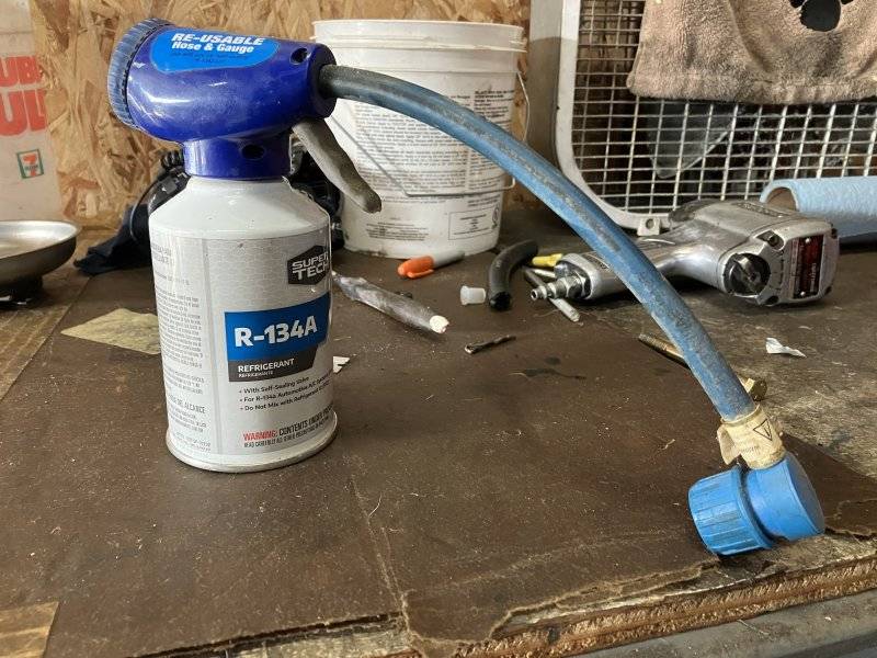

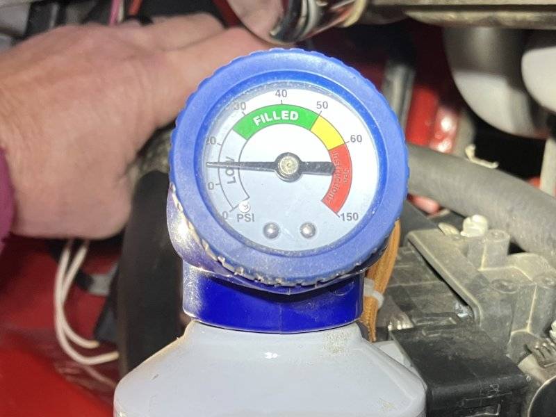

A buddy gave me this thing a few years ago.

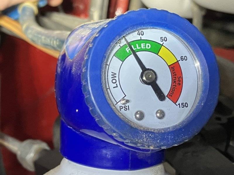

He used it on my truck when it was blowing warm air. He put it on the fitting for what he called the “low side “ and the truck was in the white zone as shown on the gauge.
I just tried it on my car.
Okay, so it did have some pressure to it. I emptied the can into it and it topped out at around 32 psi, on the low side of the “Filled” range.
Oddly, even with the higher pressure, the air still blows room temperature.
Another weird thing…the compressor clutch stays engaged whether the temp slide button is set to heat or cold.
Bad compressor?
I guess a test of pressure on the high side would tell, right? If the pressure there is the same, the compressor could be freewheeling, huh?

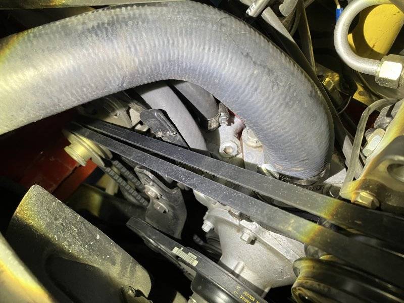

CAA does state in their instructions the Importance of the water valve placement.
Great. The lower heater core tube:
What big block has a heater hose fitting on the intake? (None)
That one I was able to follow.
It is hard to tell by the picture but…
The hose nearest the belts is closest to the water pump itself and it has the water valve in it. The second hose in the picture is closer to the block. This is where the tech guy at CAA said to connect. There is no other water port on these engines so I wonder how two ports so close together can be much different in water temperature.
First trying to get an idea of state of charge when the ambient temp is below 60 degrees is kinda a waste of time... Second reading low side without the high side reading is a serious guessing game...
Try some soapy water on the charge ports and the various connections... The fact there's still some charge means it's a small leak, visual clues would be an oily film near a connection
Most systems have black light/UV dye, green residue in the low side charge port would be a sure sign.... Auto Zone will loan you a black light...
I assume you've put a wrench on all the fittings?
Both water hose connections are hot, but one is on the discharge side of the pump and the other is on the low pressure side....

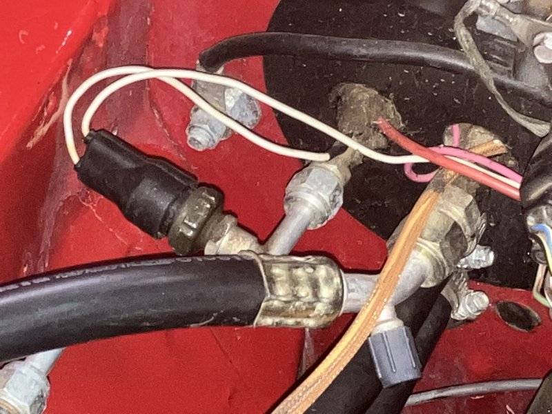

During the installation, I made sure all the connections were tight but I'm not sure that I checked them after pulling and reinstalling the engine in late 2022. I have seen no evidence of leaks at the fittings but I'll look closer.
I was surprised to see the compressor clutch stay engaged even with the slide set to heat. It did not cycle off and on and was still ON when I restarted the engine a few minutes later.
I was told that the high side is some crazy high pressure, well above what the gauge on this unit has.
Yeah, don't hook that to the high side... Sending high side pressure to that can could cause it to explode in your hand... Likely either your binary switch has failed closed or the clutch is stuck on without a signal.... Does the clutch disengage when unplugged?

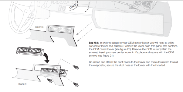

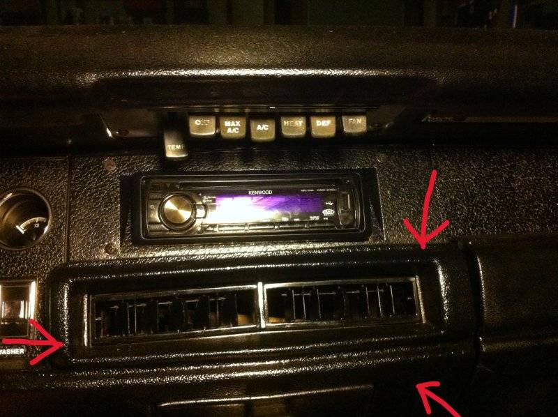

I purchased the Classic Air system for my 70 Roadrunner, non-factory air kit. I've since found a 70 correct factory air dash frame and a/c registers. I understand I won't be using an original center vent as Classic Air uses its own assembly so I just purchased the adapters for original side vents and a center vent, but now have some questions about how the center vent connects to the CA parts. My salesman said I have to have the original plenum that connects behind the center vent, possibly a metal ring that holds the center vent to the dash frame or plenum (not sure). The instructions are no help as it refers to a Figure 20, but the instructions go from Figure 19 right to figure 21, ugh. Can you tell me 1) what parts did you reuse from the original parts since yours was an A/C car and 2) how the center vent connects to the CA system? Thanks in advance for any help you can offer because Classic Air technical support was ZERO help.

I'll have to go back a bit and look but from memory:
I do remember that the lower panel in Factory A/C cars here:
....came with a new screen/grid/grille for the center. That came with some type on non stock style collar that the new ducts attached to.

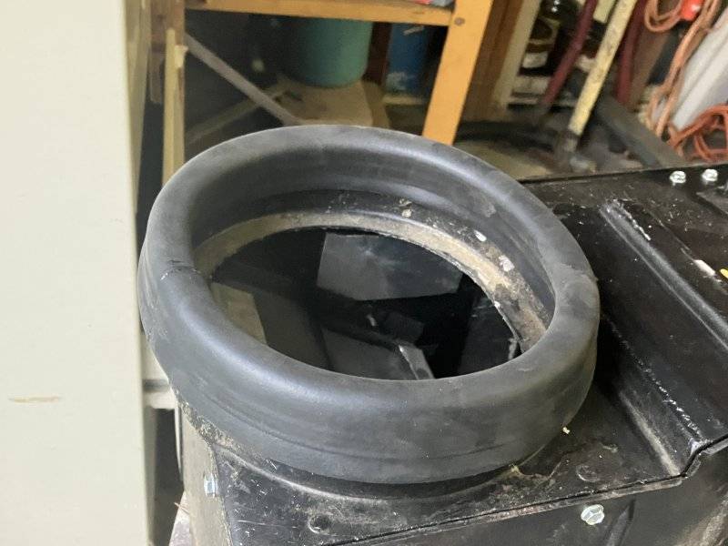

My other Charger was also. I converted it to a simpler heater/defroster but didn't use OEM stuff at the cowl, I used a rubber seal from Detroit Muscle Technologies.
The seal just stays in place by pressure, there is no physical connection .
Thanks that was helpful. I finally got it cleared up talking to Steve on CA's tech support line, the diagram you included above shows the center vent connects to the back of the dash facia plate and the two center hoses attach to two oval openings on the back which is not shown anywhere in their manuals. Thanks again, question answered!
