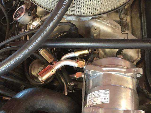

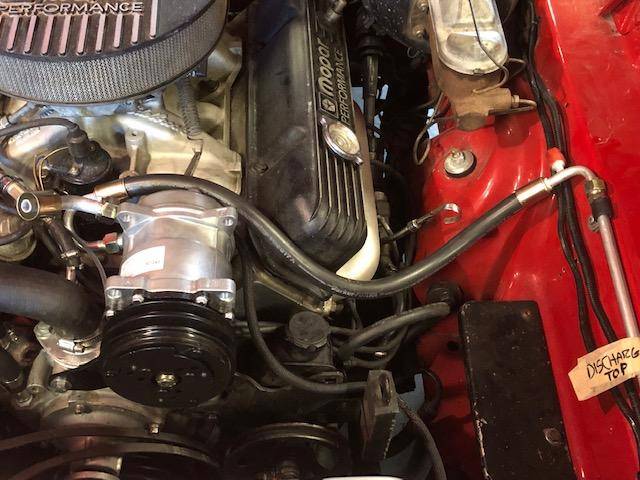

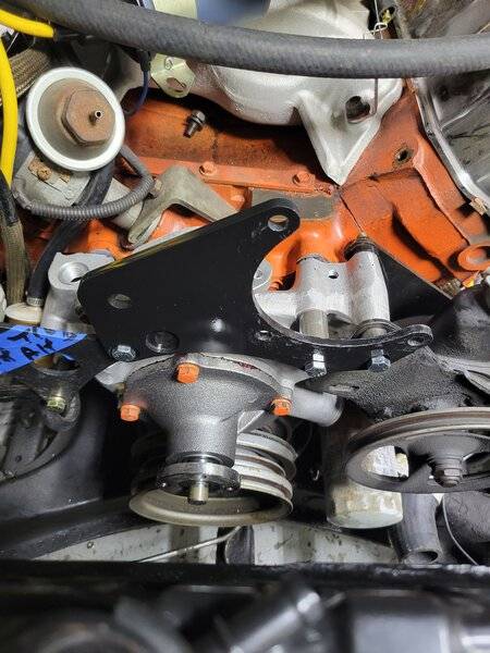

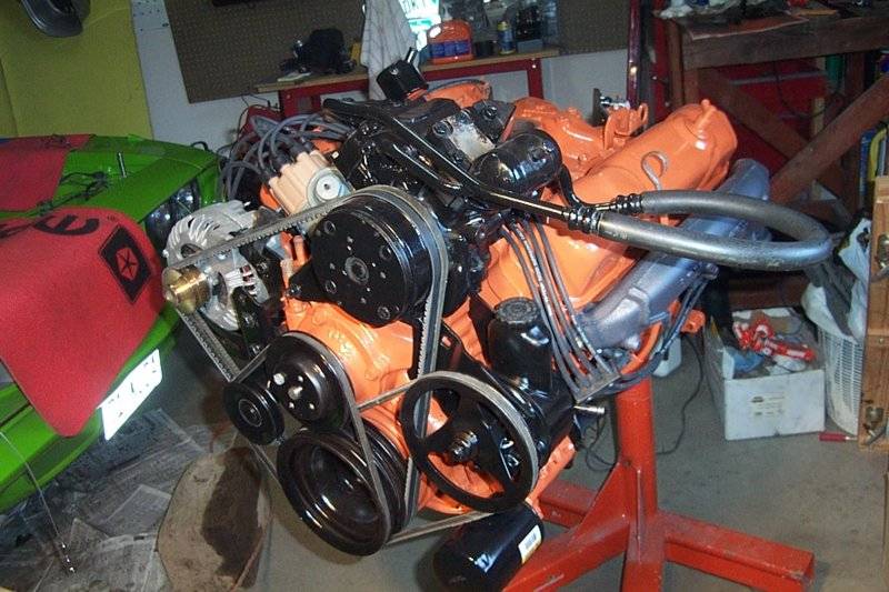

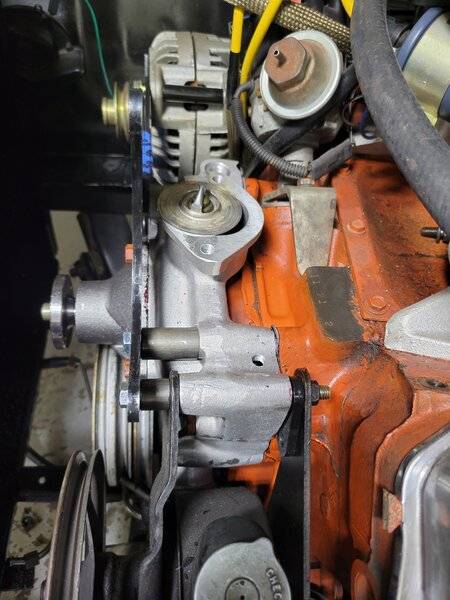

Two FBBO members went with a kit that used the add on crank pulley that required the A/C compressor to be mounted further away from the engine and closer to the fan.
I chose to use factory type pulleys, not the add on pulley so my setup uses stock sized fan belts in the stock location.
