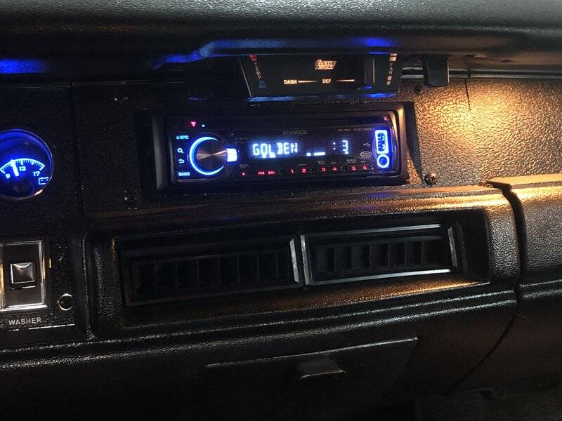

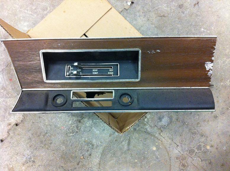

I'm not that fond of the control panel. Knobs would have made more sense than slides:
The display shows red/heat on top and blue/cold on bottom but how does that correspond with the slide? A knob with blue on one side and red on the other makes more sense to me. The fan slide is on the right. Toward the engine or toward the trunk....which is high, which is low? Maybe it is just me but these controls seem weird to me. Maybe they were trying to retain some factory appearance?

I have the same system and agree their control panel is weird. But it's like most other things; once you've used it a couple of times muscle memory takes over and adjusting will be second nature.
Knobs though....
Simple and easy to understand. Slides are fine once you get used to them. I had a Camaro and a Square body Chevy. GM loved the slide type controls. Most of our A bodies used slide type panels but they were horizontal and well marked.
Knobs though....
I agree! My old 67 Impala had horizontal slide and it worked fantastic for the 45 years it was in our family. Never an issue. The stock mopar unit in my 68 B Body has the Forward/Backward slides. It was broken when I bought the car used. I installed a re-pop from Classic Industries and that one broke within 2 yrs and there it sits. I'm in the middle of installing Vintage Air and at first ordered their stock style unit. I was in my exhaust shop having work done and saw they were installing a Vintage Air unit in a customer's car so I asked about it. They said, whatever you do - don't install anything but rotary controls - they're much easier to calibrate due to their pot design and last longer. I took their advice and ordered a rotary controlled unit from Vintage Air.
KD - you too can install a rotary control unit if you wish. Don't feel locked into using the stock style piece from Classic Auto Air. It's just wires and connections and I imagine there are many options available.
The graphic isn't clear as to which way to slide for hot or cold. I wrongly assumed that push away was cold, pull toward was hot.
Wrong. Once I pulled it toward me, the air got really cold.
