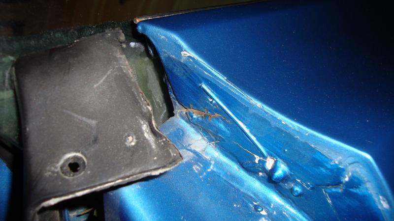

Didn't give much thought about the hardtops being so flexible until this thread.
yep. the dreaded hardtop b-pillar split. I heard about it long ago when I first started searchin for the GTXer.
mine isn't too bad right now, but it will be addressed...at the same time as the subframe connectors go in.

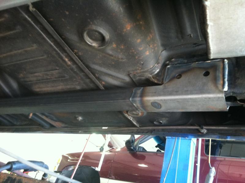

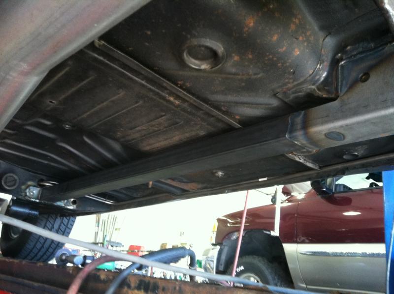

The muffler shop had a drive on lift so we did it that way. Sub frame connectors successfully welded in and only charged $90 for the work. But of course I gave the guy extra $$ on the side.
Thanks for all the advice!!
Good deal. Good price. I tip too when getting a deal. These installs are over-thought. Tuesdays, August, 50% humidity. Let us know how it drives and how the doors and trunk etc feel when handling. The first drive on a familiar washboard street was amazing difference.
Yea, I thought the driver side door issue was fixed, but yesterday it took me three tries to get the door closed. For all I know it could be tired hinges. But the car does feel firmer for sure.
