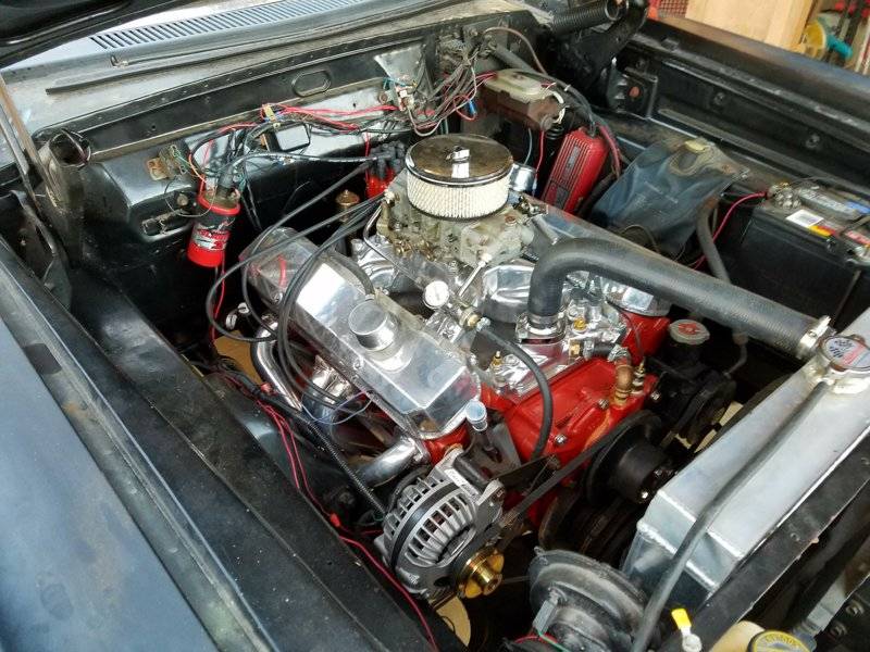

I have installed a B and M Ratchet shifter in my 360 magnum 727 trans 65 Coronet. The problem is that the only path for the shifter cable from the bracket on the transmission puts it right up against the exhaust header where the cable goes across the bell housing. I already ruined the first cable. I have found a way to route the cable, (using the ruined one) so that it only touches the header in this one place, but there is no getting around this one place. So my questions are, 1) how did others handle this dilemma, 2)What are the best materials to wrap/insulate the cable at that point, 3) should I get or have made a cable that will tolerate this positioning, if so from who, or s
hould I get a whole different shifter/cable assembly that avoids this issue? Very interested in anything that will fix this for the last time. This is really a jumpin' hot rod with over 400 HP and a 4500 stall converter and a 3.55 to 1 posi. I love it but don't want to be fixing it over and over. Help Help

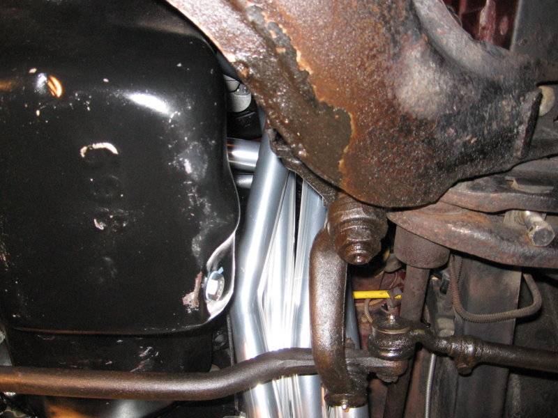

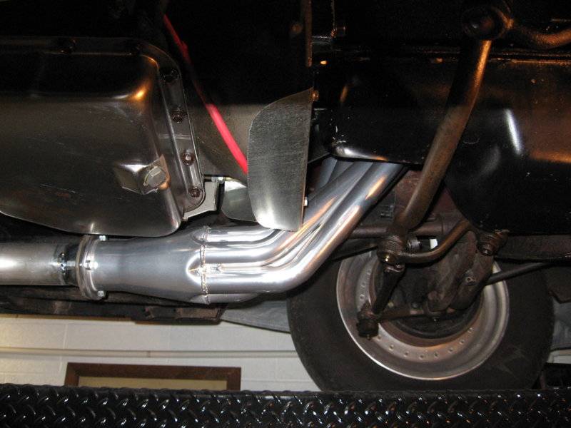

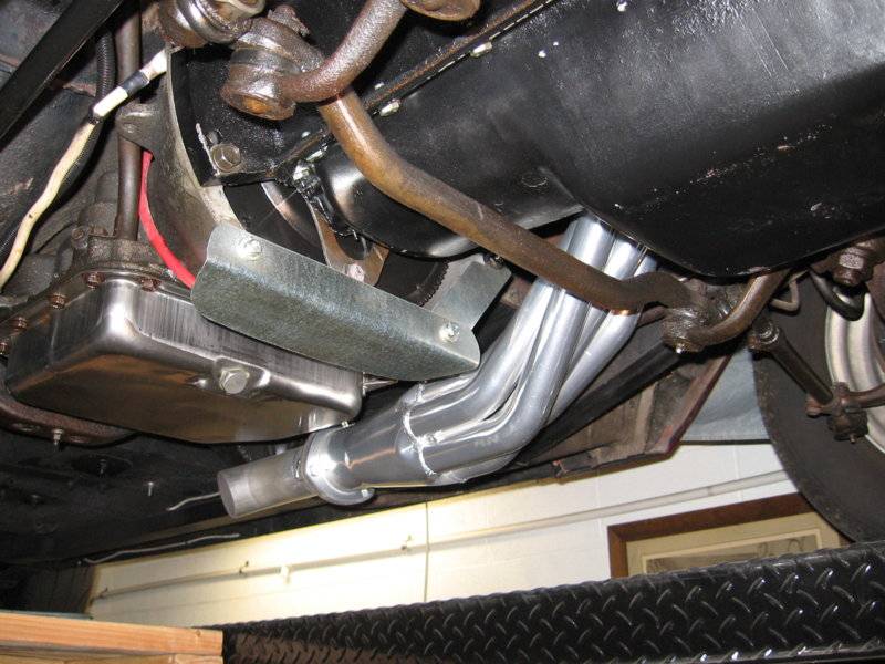

Her are some old photos of a Dart,904 trans,not that the 727 is much different,B&M shifter. Had the same problem. Routed the cable to the passenger side of the transmission and under the bell housing. I think I used their 6 foot cable. I did make some heat shields along with a tin plate to hold the cable under the bell housing.That was almost 20 years ago and still working and no burnt cable. Just a thought and something for you to look at.Not the best photos but to give you a idea.
A 4 foot cable routes much better than a 5 foot cable.

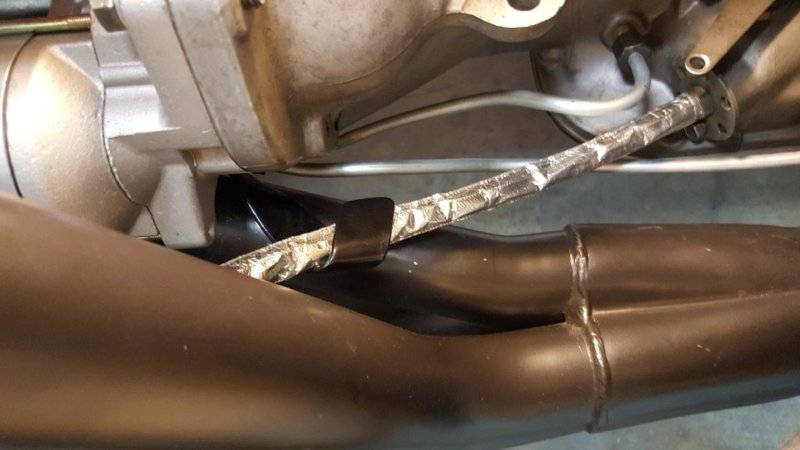

Hey Purple, thanks very much for all your ideas. I will be incorporating some of them. I have some reflective heat shielding material that I am thinking of making a box shaped tube out of to go over the cable in the contact area after baseball wrapping that entire area of the cable with 3M 2242 self sealing tape which has, I think, better heat resistant properties than just the red rubber cable jacket itself. Then I plan to put another thickness of the heat shielding between the "box" and the header which is already wrapped in DEI Titanium header wrap. Hopefully all these extreme measures will work.

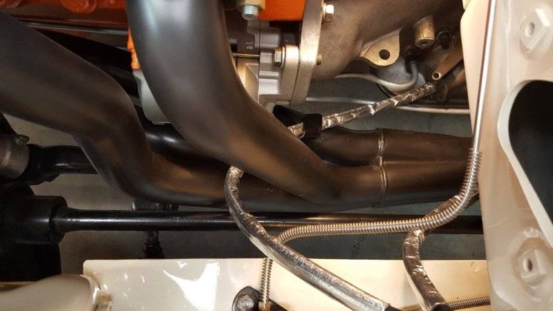

On my '62 I used a foil insulation over a sparkplug sleeve. Ran the shifter cable through the header and park gear over the headed where the factory had ran it. Bought the plug wire stretch cover and foil sleeve from Summit. Good for hundreds of degrees and double protection.
Made a bracket bolted to the bell housing to keep the cable in its place.

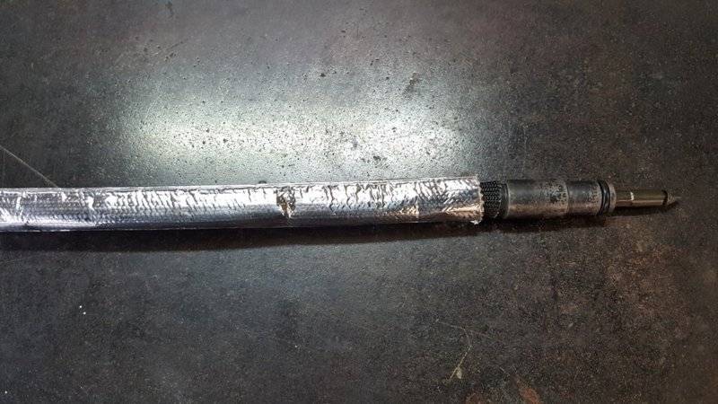

DEI has heat sleeves at Advance auto parts, or Auto Zone. In the high performance section. Been on for 10 years.
I had the same issue. I burned 2 cables and wanted a permanent fix. I wrapped the headers from top to bottom with the DEI titanium wrap, to double up I then bought a DIE titanium 6' sleeve. Haven't had any issues since.
