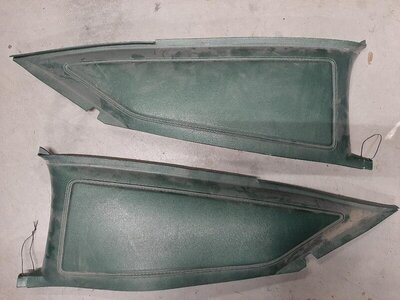

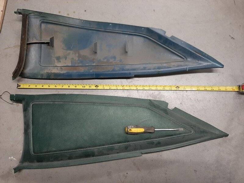

Can anyone tell me what the panels in the photo go to? I'm cleaning out my shop and I think these are Plymouth pillar panels. I'm getting rid of parts that don't work on my 71 Challengers or my 74 Chargers. Thanks.

ley look to me 72 SE. But I think they are pretty much the same than 73/74 Satellite, 72SEs being longer ?
there are repro for these now, like 71 and 72 Hartops.
73/74 Chargers are still orphan about these :(
The quarter window opening ( the ends with the wire loops I put on ) ends did not look like any year Charger opening. If i dont find a home for them, in the trash they go.
Terry
There should be a part number on the back. Could be 73/74 Plymouth, not sure. They are NOT 73/74 Charger.

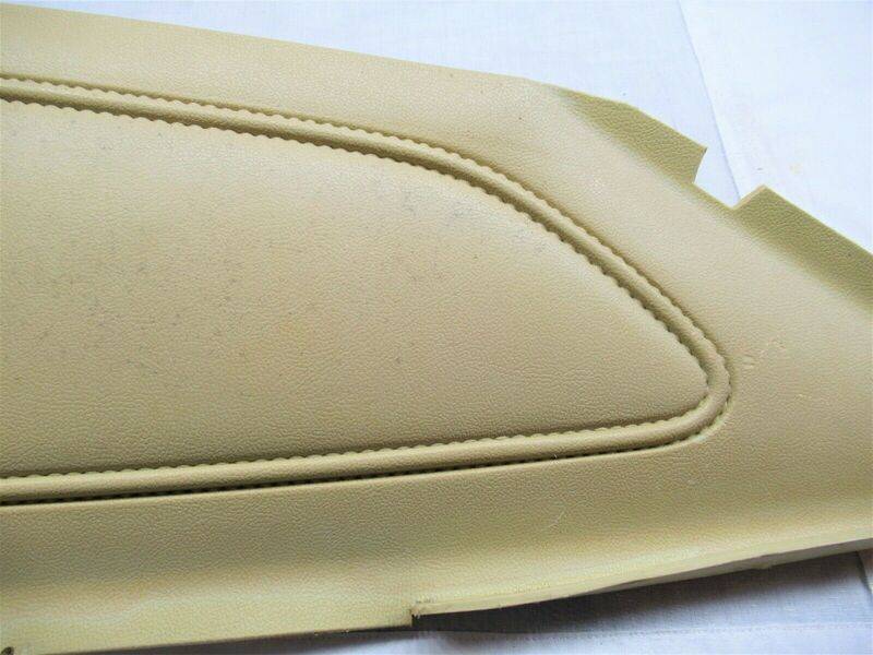

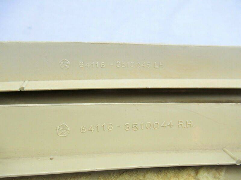

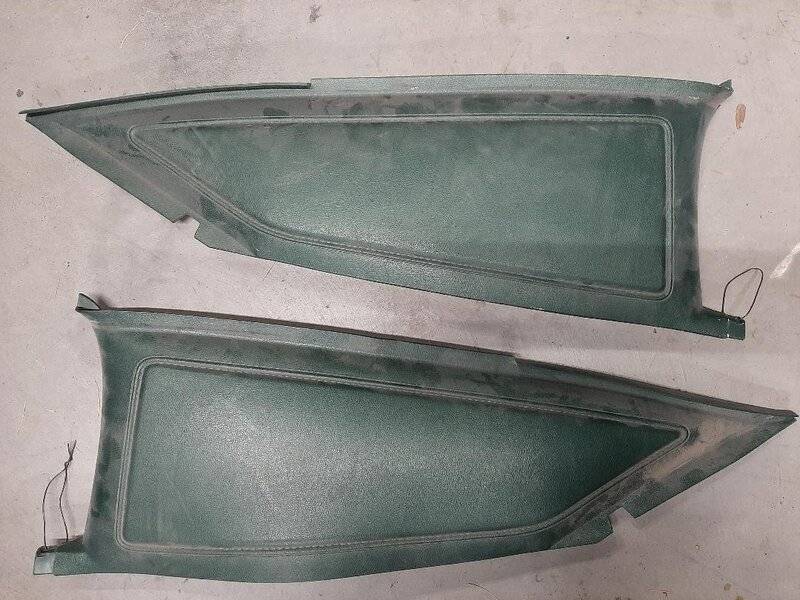

The 72 SE panel looks close Nacho. The over all length is about 32 inches. Note that in the photo with the screw driver pointing at the fake inset stitching, the stitching in the panels I have come to more of a point than the rounded stitching on the 72 SE. The other photo has the part number. Thanks.
Terry

Bingo. Running that part number shows a set on Ebay that are identified as from a 73/74 Plymouth Satellite Roadrunner. These have been dyed so not much use keeping them. Thanks.
