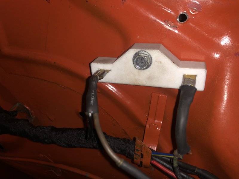

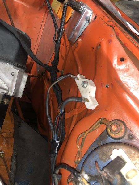

I have a random no start on a ‘71 440 charger that i converted to electronic ignition. Coil will have 12v with key in crank position but no output from the coil. I replaced the coil and the ignition module, still has the same issue. I have the “key run position” blue wire tapped into the blue/yellow wire for the ignition module on the same side of the ballast resistor. On the other side of the ballast is the 12v for coil and and brown wire for “key start position”. Is this set up correct?

The factory electronic ignition needs good grounding, Block to Ignition module, and a good battery ground cable and connections.
Also check the reluctor air gap in the distributor, s/b 0.008"

Reluctor gap is at .008, has good ground, even made a jumper wire from battery neg to ignition module.
Best way to test is to separate the starter circuit from the ignition circuit and use another battery to power the ignition.
Just leave the key in the off position, then connect another battery with positive (+) to the ignition circuit at the ballast resistor, the ground (-) to the block.
Use a starter switch at the netural safety relay to crank the engine with the original battery.
If the car starts, the problem is in the wiring (maybe voltage drop or ground loop problem?) and not the ignition components.
If it does not start, the problem is either the ignition wiring or ignition components.
