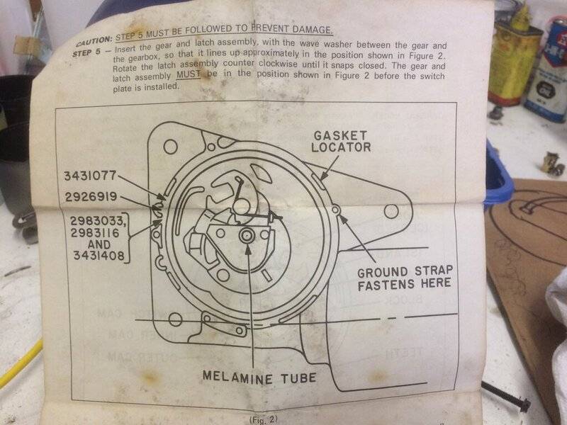

Does anyone know anything about these intermittent wiper motors? I took the cover off the gearbox and reinstalled it but the motor didn't work as it did before I fixed it. Just a loud clicking noise coming from that location when I hot wired the motor. This cover has a mechanism/switch on it that parks with wipers. It's not damaged just need to find out how it needs to be assembled.
Many thanks
This may help

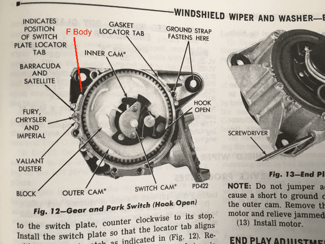

I hate when that happens... Are you aware of the three locations for A/B/C body? if when you installed the cover it b

No, but enlighten me.
if you look at the pic I posted above you will see the numbers to to the left and lines pointing to the different positions for the body style. It’s the same on the earlier ones too.
