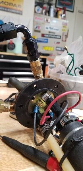

Rewiring new fuel pump (Walbro 255) I want to use heat shrink on the connectors that attach to the end of the fuel pump harness. I use MSD duel wall, tube set with adhesive heat shrink. It is made of polyolefin. The connectors attach at the top of the fuel pump mount plate so they will not normally be submerged in fuel but they will get fuel splash, fumes, etc. They will be submerged only with a full tank. Will this heat shrink perform satisfactory in a fuel tank environment? I don't want them to turn into goo a few years down the road.

Google "polyolefin chemical resistance" and you'll have your answer. In your photo I don't see anywhere you'd need heat shrink.
Whats in the pic is the hardware that the old pump came with. The new pump came with nothing.
Polyolefin is considered fuel compatible but there is some debate on to what degree - submerged vs environmental exposure for example
Because of the small circumference of the cover plate better hose clamps cannot be used. They will interfere with the cable connections. I'm sure there is a better clamp that will work somewhere - perhaps the Mopar crimp clamp as suggested

The same connectors as in your photo are readily available virtually anywhere. But as far as insulation, I don't see the point as there's no way they'd touch each other unless one fell off - and then you'd know it pretty quick!
