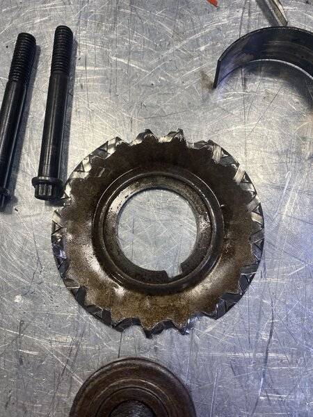

I have two threads I want to combine them for some advise. long story short, I lost oil pressure in my 440 A-12 and come to find out I have a bronze scrocket on my intermediate oil shaft and it did break apart. I will confirm but I believe I have a standard cast iron flat tappit cam. I do not have any history on the engine, so I can't explain why i have the bronze sprocket. I also notice my oil slinger is on backwards and coming apart I found several small peices in the oil pan. The engine ran fine before the breakdown. I don't race normally but have a friend that can't leave well enough alone. The timing chain appears to be alittle loose, I'm not sure whats within tolerance but can confirm. The oil pan is already off, I could replace the oil pump, shaft & steel gear. pull the timing chain cover and replace oil slinger, chain and gear set if needed. This would let me drive it though the summer and fall then if needed tear it down over the winter. I dont want to do further damage, so option two is just pull it and rebuild the engine, the engine builder I use is about two months out but I'm trying not to let that influence my decision.

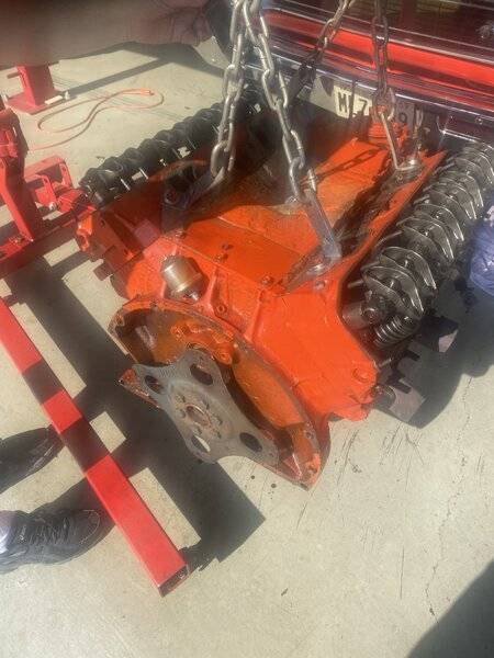

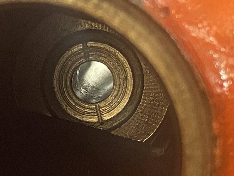

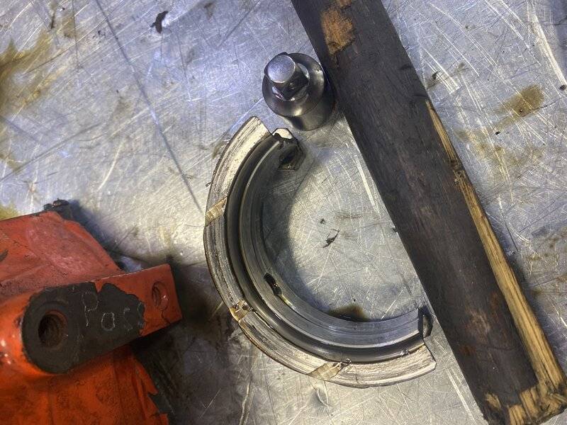

Here’s the deciding factor
the bushing was scared up.

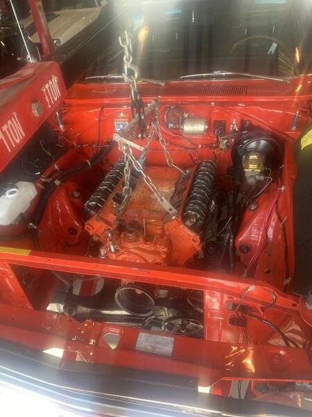

I had a friend off work and ready to help, I found a machine shop that could start as soon as I got it out. I don’t think he figured we would get it out today.
I’m surprised it was running so well when in such bad shape. It ran pretty strong no smoke and sounded fine. It was very tired and and on its last leg. Much worse then I thought it would be.

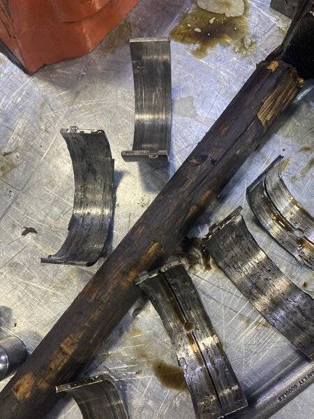

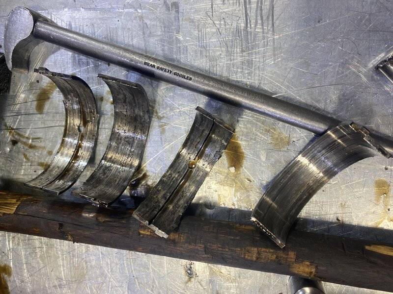

Wow, there was alot of stuff going through that engine that was not oil.
I wiped out a single cam lobe on my 360, and I though I found it pretty quick, but I still had to re-hone all the cylinders, new rings, and replace the bearings and oil pump.
Good call taking it apart.

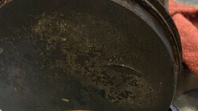

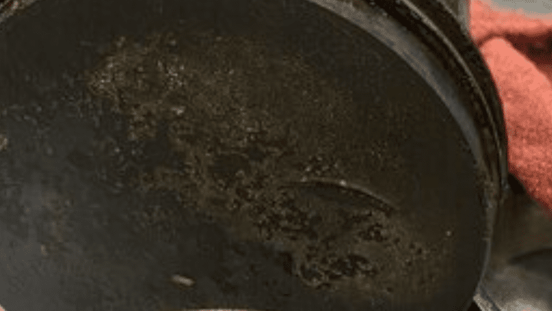

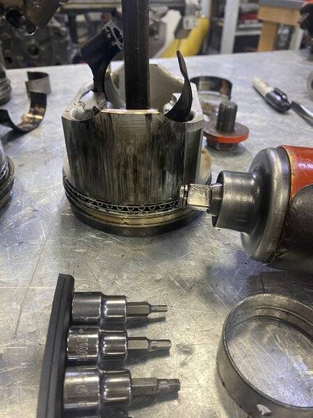

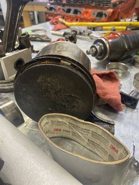

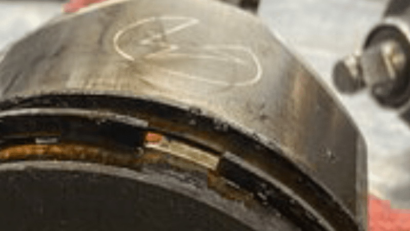

It’s already been rebuilt before, and had Sealed Power forged pistons in it.
Looks like there was some valve to piston contact at some point, as the piston didn’t come with the little “eyebrow”.
If you scrape the carbon off the top of one of those there should be a part number stamped into it.

damn that is ugly. I can't believe it didn't spin a bearing or 4. hopefully the crank isn't chunked
View attachment 960151 View attachment 960152
Yup, I was looking at that too...

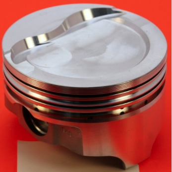

Something like the Icon IC836 which has a 12cc dish... Funny 383's you can't hardly build cylinder pressure, a 440 it's easy to build more than you really want on a street car...
