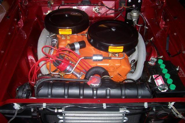

I am building a 64 plymouth Sports Fury and I want to make it a max wedge clone. But I really like cruising it in town and to burger runs. Is this intake really street-able or will it give me HELL!
My engine is a 30 over 440 10.25 /1 compression cast heads 509 mopar cam with a M1 signal plane on it right now with 3500 stall. Its not in the car yet but was in my 70 duster and it ran real good!
So would it work? will it need more stall? more cam? or is it not worth the big buk$ to make it a Max clone? Tell me your opinion on this! Thanks!:confused:
