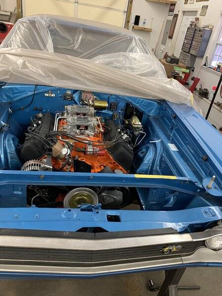

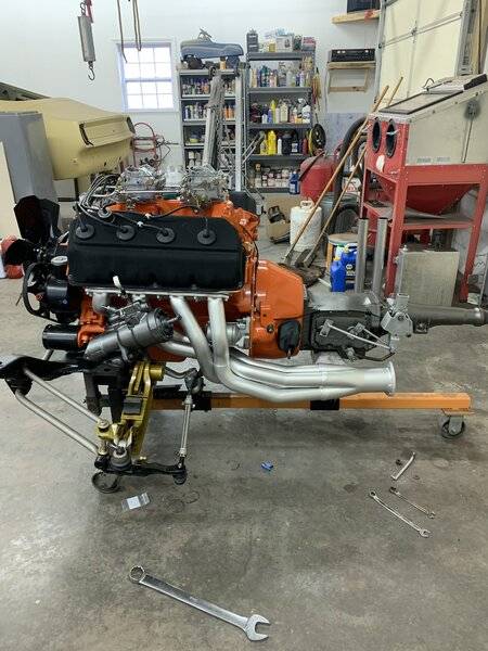

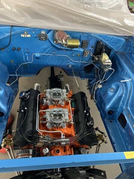

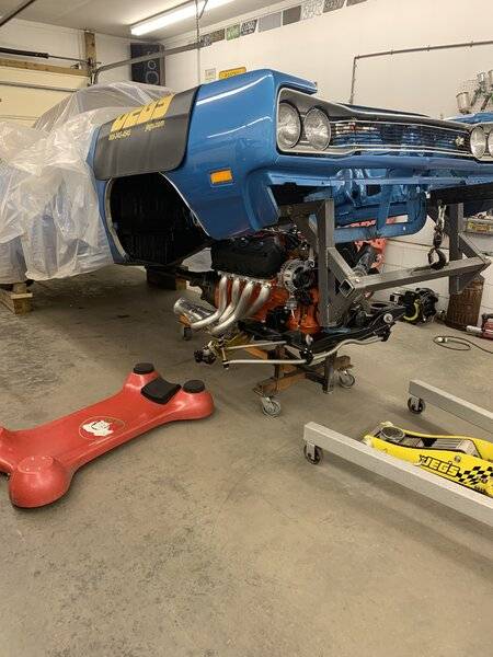

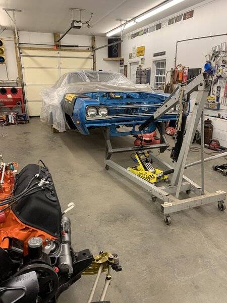

Got the engine in the Bee today still have to do some mods to the engine mounts as I’m a bit crooked side to side for some reason. Anyway here’s a few pics.

It was a tight squeeze going in from the bottom for sure ended up having to remove the passenger side valve cover.
The conversion mounts I bought are nice but I’m gonna have to do some work on the passenger side one to get everything in line. Couldn’t get the gearbox to line up so I removed the right mount and bolted the trans to the crossmember.
Then took some measurements need 1/8” to the rear on the right side mount to get it right.
