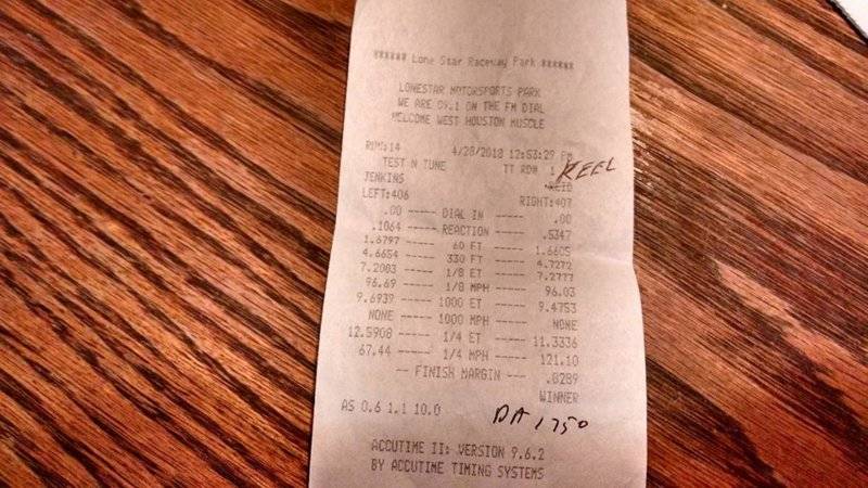

It is alive again
This is a video that goes with the time slip I posted, I was asleep at the tree left easy & short shifted. :)
2nd race, I went up against the converter & blew the tires off.
I wont talk about good or bad air, or tuning with good or bad air, the car ran what it ran. I have done no tuning yet , but it dont matter air wont change what it ran:)
cool videos cdr, thanks for sharing
you ran down that stang :thumbsup:
left on the Camaro :thumbsup:
