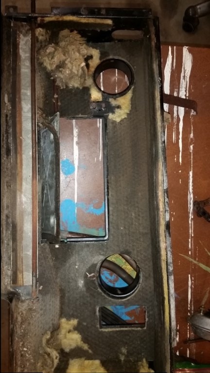

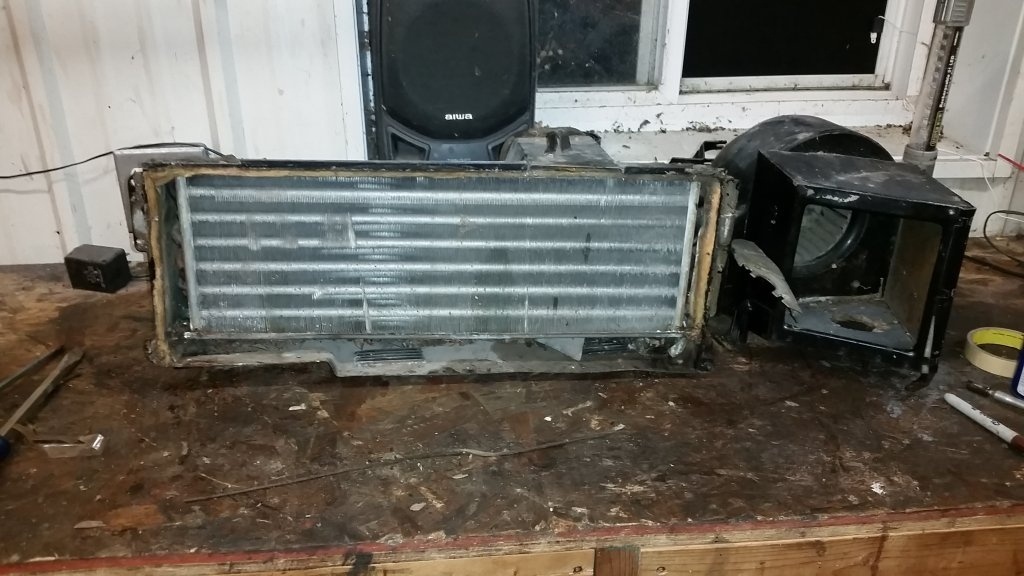

Next you remove the cover bolts. There are screws that take a 5/16 socket and nuts that take a 11/32 socket. After that gently pry the box apart at the lower seam, working your way up. It will tip up to separate the heater core from the evaporator.
To remove the heater core, there are 2 5/16 screws on the cover that need to come out. Then there is a 1/4 screw that holds the linkage to the center vent flapper. Remove that also. The heater core will then separate.

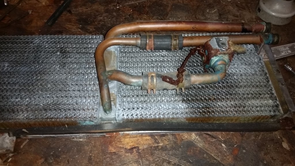

I forgot to mention, before you remove the heater core, the inlet lines need to come off. There are 4 1/4" drive screw that come out, then just slowly work the inlet lines off. They just have an o ring seal to the heater core.

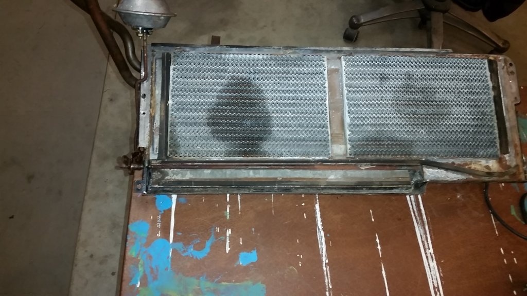

I will pressure check the heater core for leaks. If it checks out I will clean up the box and install. If it fails I will be going with an aftermarket system, probably classic auto air. It simply cost to much to restore a factory AC box for my application.

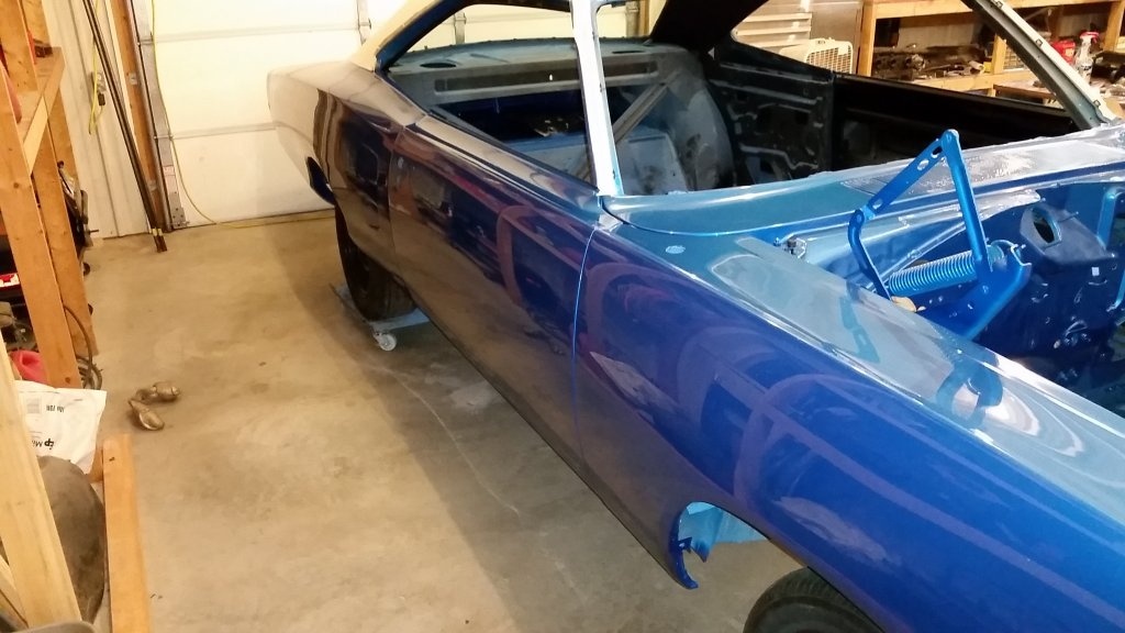

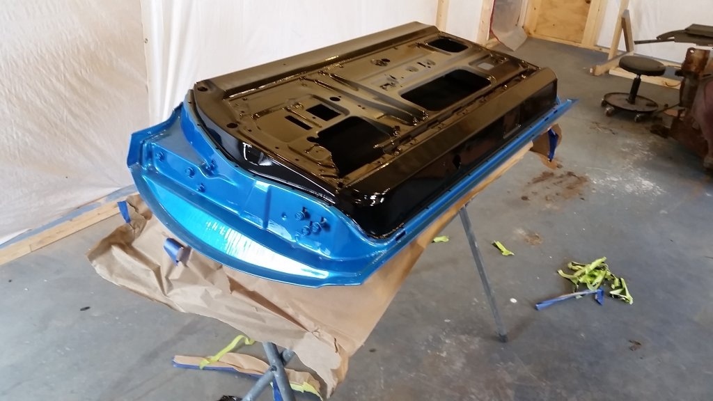

Waiting on some parts now. My body gasket kit and 1/4 window regulator rebuild kit will be here this week. Tomorrow I will color sand and buff the doors, then they can be reassembled.

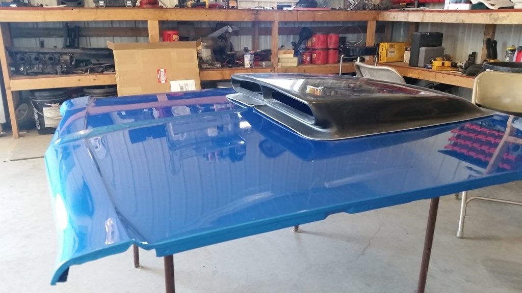

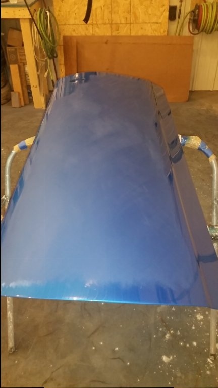

In the next few days I need to get going on my hood. After I painted the car I stood back and said "that's alot of blue". I always wanted a 6 pack hood, so why not. I will mount the scoop and paint the hood with a low gloss black.

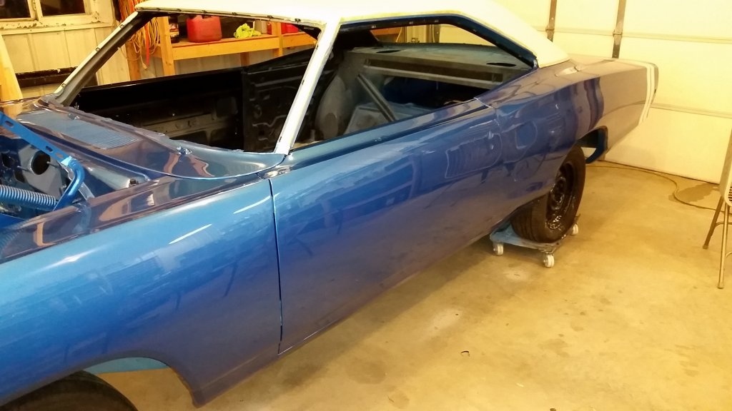

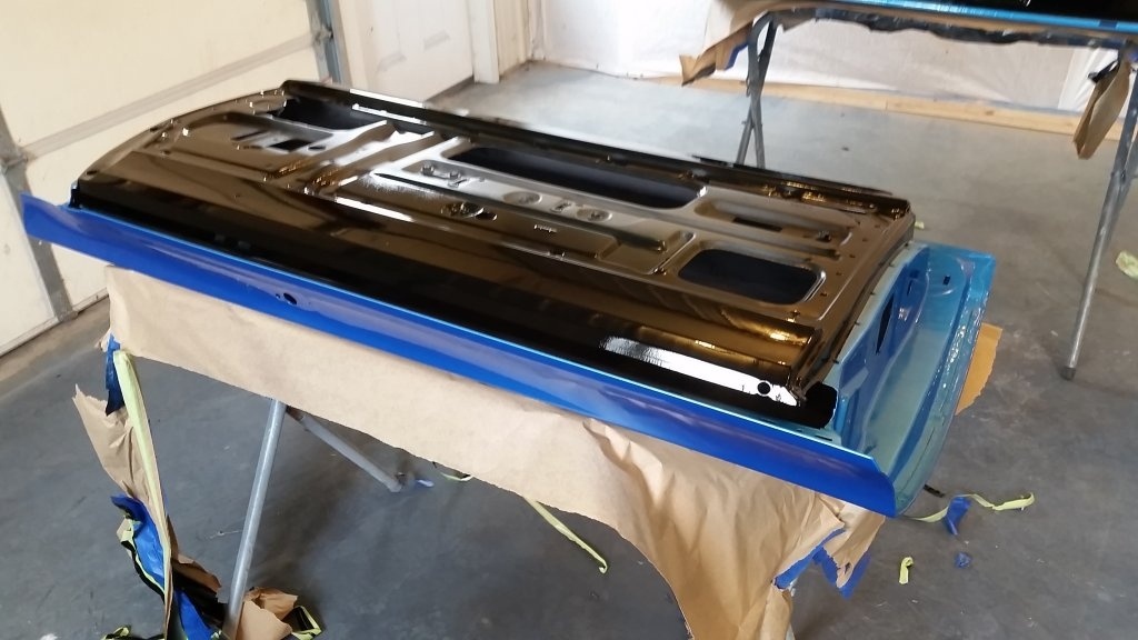

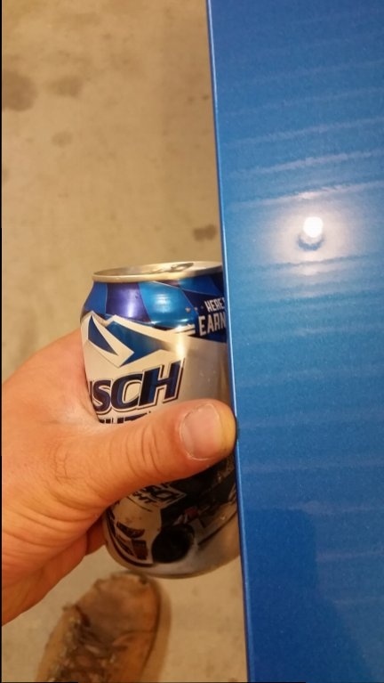

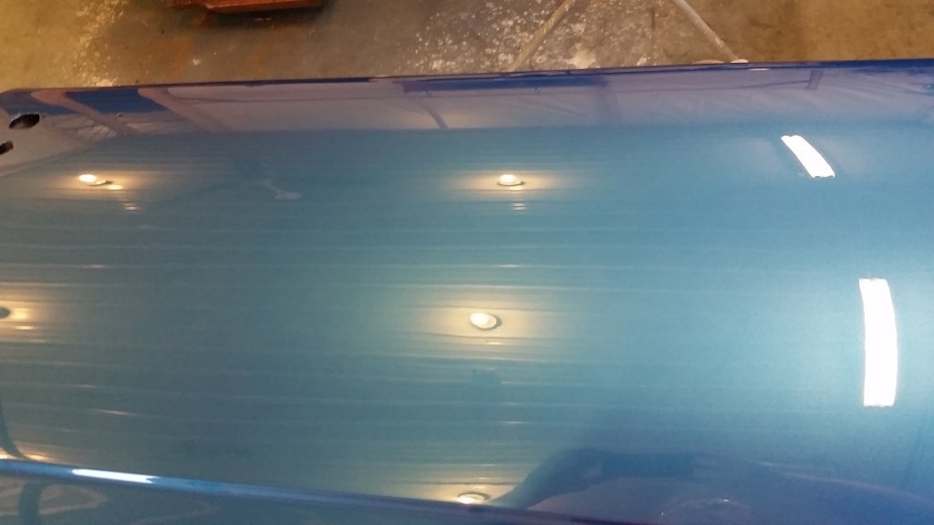

Down to just the doors for sanding and buffing. After hitting it with 1500 grit.
After sanding with 2000 grit, wool pad and compound, white foam pad and compound. Still have to hit it with the black pad and polish to go for the ultra shine.

Mine is also a black interior but I am contemplating bringing the body color inside by not painting the door black on the inside. Have you seen an example like that?
I think the orange and black would look nice. Mine has white door panels and seats, which is why I went with black.
Ah so you will have contrasting colors on the door. That's what I thought. Orange with the black panel and black Coronet 500 placard would be sharp
