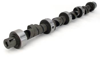

High Energy™ 268H; 1200 - 5200 RPM Range
Product Representation: Actual part may vary based on configuration ordered.
Part: 21-215-4
Price: $154.09
Weight: 10.08 lbs FREE SHIPPING OVER $50!
Quantity:
HYDRAULIC • Great Replacement for 383 Magnum w/ 650-750 CFM Carb, Dual Plane Manifold, etc • Smooth Idle 440 w/ Super Torque
