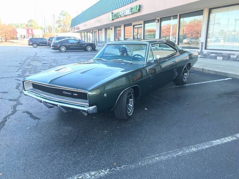

Just found this Hemi swap forum - My Hemi Swap 68
Coming within about a week....... Holley EFI Terminator X for the 68 Charger!
I'll explain why I'm changing and document the process.
Stay tuned!
Ryan

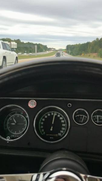

My drive there on the interstate. Not bad for 3.73 gears and a 28" tall tire. 2,900 rpms at 80mph.
The new Holley Terminator-X computer system worked flawless.
Car cruised like a champ!

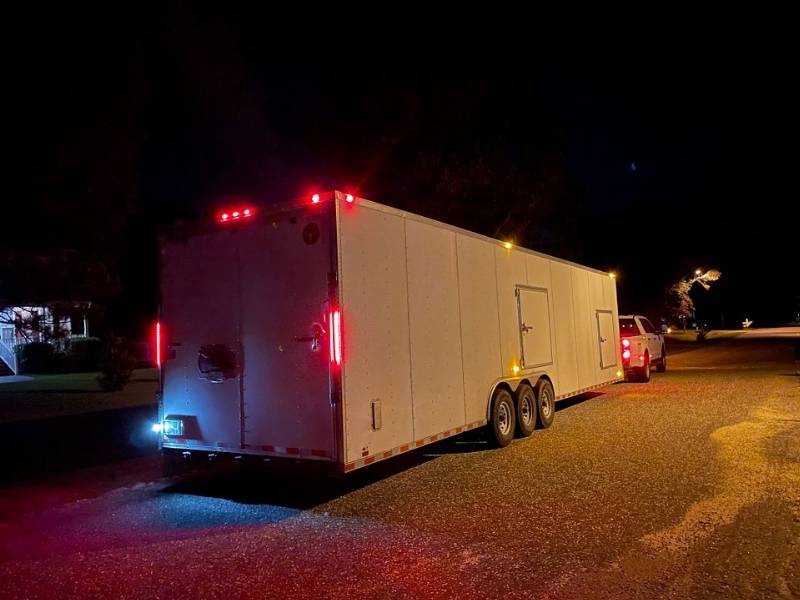

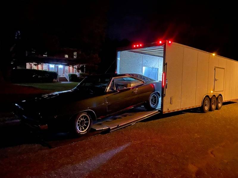

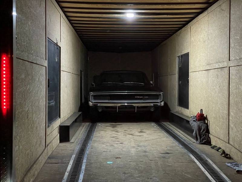

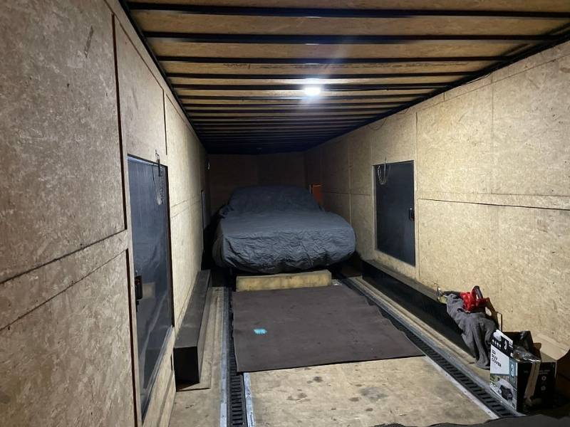

Full circle on this project.
Sold the car May 2025.
Had a lot of fun building and driving it over the last 5 years.
Sold it to raise the funds for my daughter to attend a 4 year college (starts after this summer).
Here's the last pictures of it as I got it loaded into the shipper's trailer last night.
