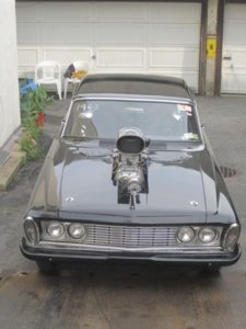

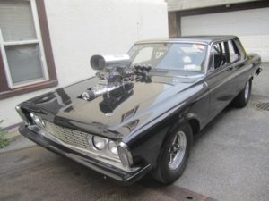

Keeping the hood down at high speed 62-63 Fury
I would think that tightening down the latch and adjusting the rubber stops so the provide a little more pressure to the sheet metal would help.
I can’t see them! Are they the common ones in the usual spot?
Common parts. Pins are screwed into welded nuts in the hood. Pins go through holes in the core support. Clips are accessed through small holes in the grille.
Doug
Looks fine but my car has the stock look and I will keep it that way unless I want to go fast like you
I like the stock look also. But I also like the day two look for a street/strip type car like mine. Good luck with yours. Ron
LMOFL !!!!! You guys having this problem with a stock steel hood???? This is the same reason I don't use a hood at the track,the hood starts to curl upwards at the front curve.I tried some aluminum braces to no avail:cursin:
