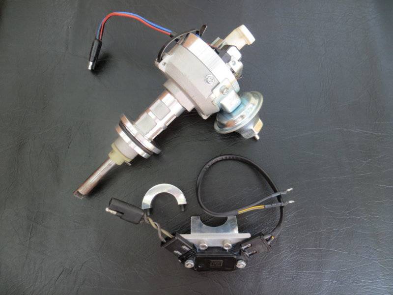

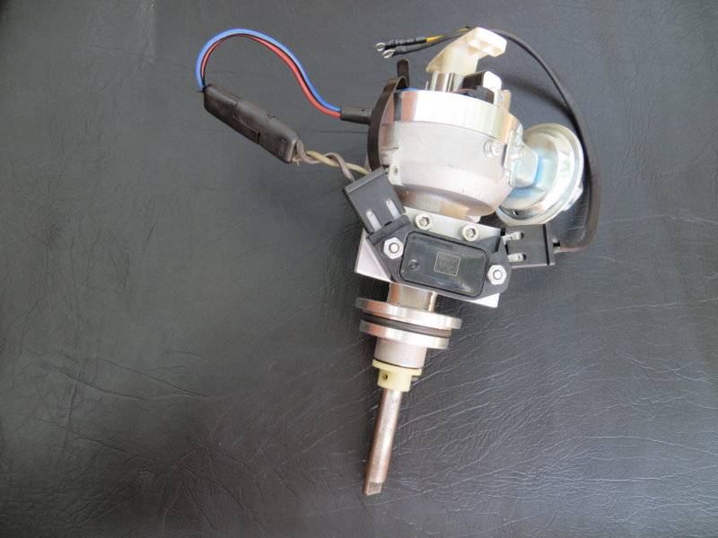

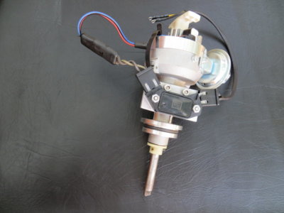

Tired of my ignition problems on my 1971 Charger, I decided to make my own using a GM module (I already hear the screams) and an E-core type coil and some bracket fabrication.

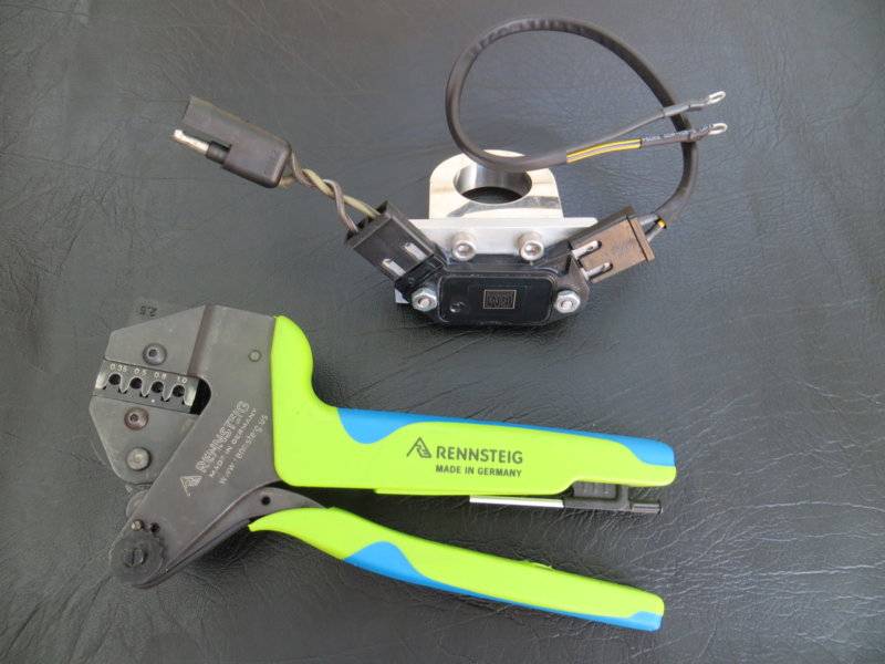

To install: mount the collar to the distributor, connect the distributor plug, one wire each to the + and – coil terminals and turn the key! When I turn the key, no more few turn overs of the engine… it fires up immediately! The performance on the road far surpassed my expectations. For a professional install, I used OEM Delphi terminals and my Rennsteig PEW12 hand crimper. I'll never be stranded again, as I can pick up one of these modules anywhere. My collar distributor mount isn't completely necessary and was just to hide it, as I still have my orange box there to look correct. Not bad for $75 in parts for the module, coil and aluminum pieces!
Difficult starting and sluggish performance no matter my timing and with a new coil and carb. I never determined the real issue: ballast, ignition box, wiring..unknown. This HEI test took all of 15 minutes to try out (unmounted), and it was incredible. I guess I could have bought an MSD box, but I'm a sucker for doing it myself. My 271 open gears tires never broke before, but it sure does now. The 8 3/4 is next.

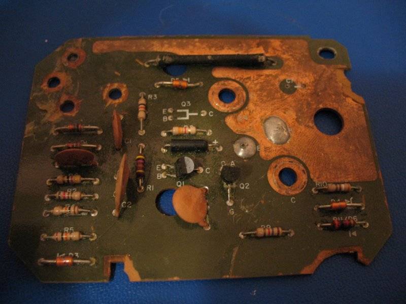

I actually tried to do that but the circuit board is epoxied in and I’d destroy it getting it out. I don’t get why there is so much resistance by people for this kind of upgrade. As GM’s modules are used in all kinds of equipment and they are upgrading the inside resistors, capacitors, etc. To me, hot rodding is all about performance… I’ll leave brand loyalty to the collectors.

Nice photo 451MOPAR! I wonder if those resistors-capacitors were just upgraded (MILITARY spec!), would it be a killer ignition????

This is the guts of a Mopar Orange ECU. Not much in there.
If I remember the circuitry, the large resistor on top would be like the one in the dual resistor ballast resistor used with the 5-pin ECU. I think the diode below is a Zener diode and that combination makes up the ECU power supply. The components on the left side of the board condition/detect the magnetic pickup signal. The components in the center create the "timing", of how long to turn off the large external mounted power transistor.
