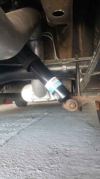

Got around to swapping the rear Bilstein shocks into my 69 GTX. The upper sleeve for the Bilsteins was shorter than the KYB so I put the KYB sleeve in the Bilstein upper bushing. Very easy swap. I measured the travel of both for comparison.
KYB. 22 5/8" to 14 1/2"
Bilstein. 22 3/4" to 14"

I went from KYBs to Bilsteins two years ago and it really feels like a more modern ride. I had the same sleeve issue. I have yet to experience that old faithful mopar frame/bump stop slam over a pothole or bump when it's unavoidable. :) Enjoy!

I can jump in since I did this. The Bilstein sleeves were either too loose and/or too short. I used the ones from my KYBs as well. I will say I wondered if the Bilstein thing was hype after not having the correct sleeves, but let me tell you, I've never had any mopar with stock suspension take bumps like these bad boys. :) No more mopar slam bang over potholes in the road. Just a gentle/firm bump and it keeps going.

The Bilsteins just soak up the bumps. Harsh shocks will not let the suspension move so the tire takes all the impact. Soft shocks let the suspension move too much to where you bottom out.
KYBs are a crutch that work okay with soft stock springs.
If you're running bigger torsion bars, leaf springs and sway bars,. the KYBs will be too harsh.

The deal is Bilstein makes the shocks, but they don't actually make a shock for our application.... If you buy the shocks from Firm Feel or Just Suspension you'll see an RCD sticker & part number...
What RCD has done is search the Bilstein catalog & found shocks designed for cars with similar weight to our cars, and similar suspension travel... the mounts are modified to suit our application... And naturally they couldn't get it right.... Just to much to ask..
But at the end of the day Bilstein makes a damn good shock & we can deal with the shortcomings....
