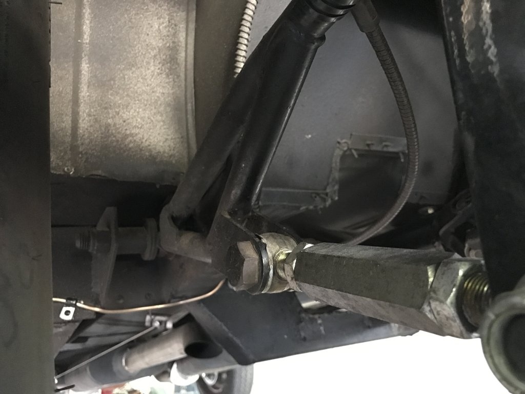

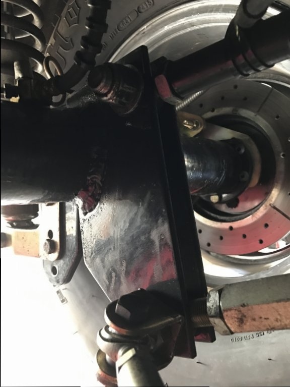

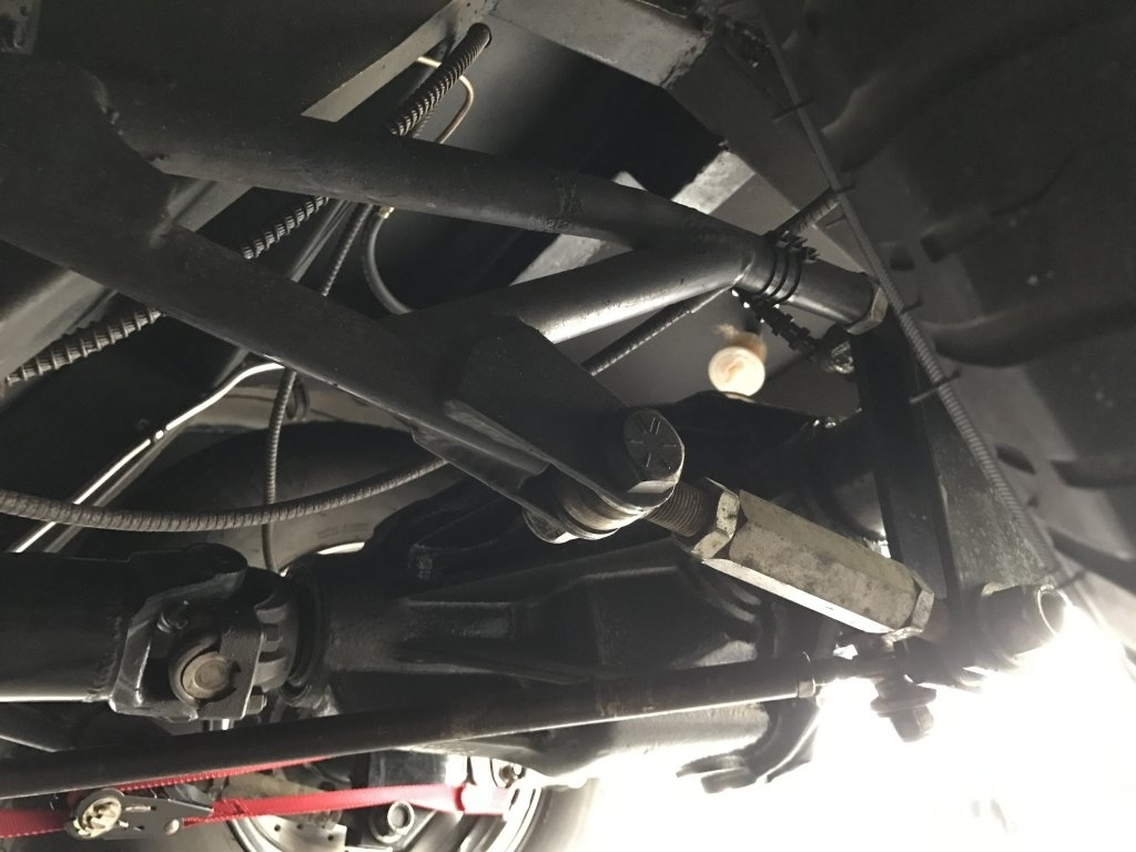

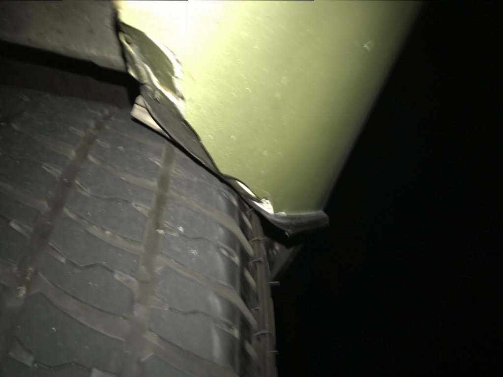

Wow !!! Thank god I was this was not worse ! since I had my 83/4 changed to a Dana 60 410/Detroit locker nothing but trouble the last trouble.. the other end of the ladder bar at the axel housing welds let go but I noticed the cracking and stop driving the car they were re-welded and seem strong and now this on the opposite end of the ladder bar what now ? it's not the installers fault this time... and honestly the Dana Howes like hell when you get in third gear and fourth gear at 40 miles an hour....and the rear is all new supposedly perfect wear pattern ... the Eye just snapped off right at the locking nut do I switch to Caltrac mono leafs ? It scares me to think that could even happen breaking it off at the end of the quarter mile what are your thoughts ... ps on a positive note i'll be eliminating some Bondo behind that rear tire on the repair it's pretty heavy there I wonder where else on the car is hiding
I agree no safety loops huge no no! From the sounds of things it maybe time to start over fresh with the ladder bars
Replace all the heim joints with good quality ones and perform maintenence on the joints and make sure all locking nuts are tight at all times.
View attachment 370228 View attachment 370227 View attachment 370225 Wow !!! Thank god I was this was not worse ! since I had my 83/4 changed to a Dana 60 410/Detroit locker nothing but trouble the last trouble.. the other end of the ladder bar at the axel housing welds let go but I noticed the cracking and stop driving the car they were re-welded and seem strong and now this on the opposite end of the ladder bar what now ? it's not the installers fault this time... and honestly the Dana Howes like hell when you get in third gear and fourth gear at 40 miles an hour....and the rear is all new supposedly perfect wear pattern ... the Eye just snapped off right at the locking nut do I switch to Caltrac mono leafs ? It scares me to think that could even happen breaking it off at the end of the quarter mile what are your thoughts ... ps on a positive note i'll be eliminating some Bondo behind that rear tire on the repair it's pretty heavy there I wonder where else on the car is hiding

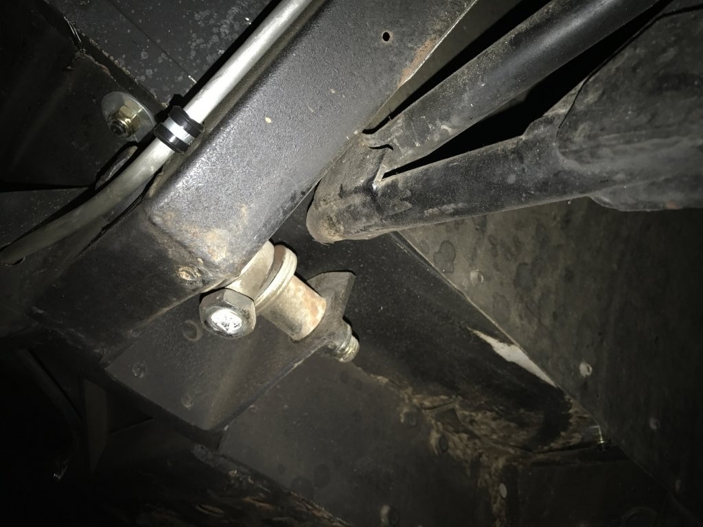

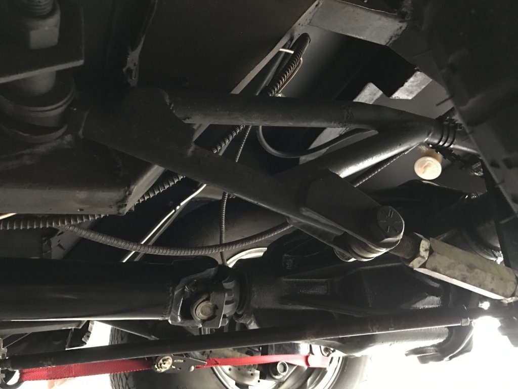

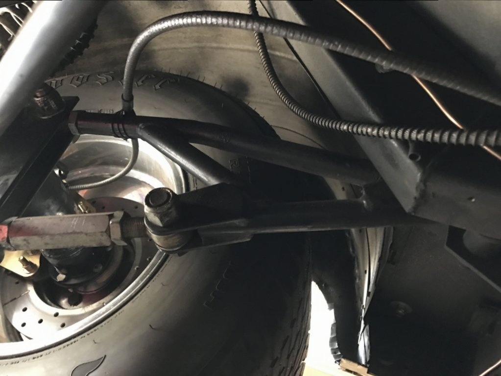

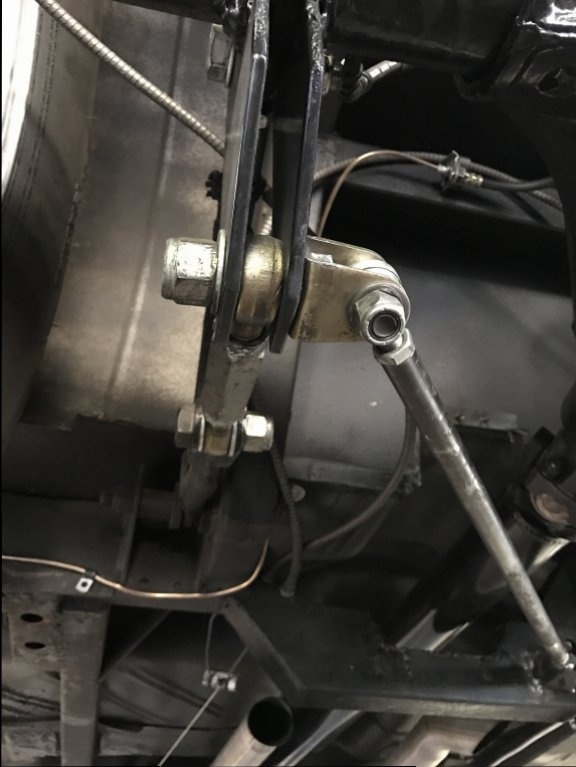

Here are a few more photos i'm not the most knowledgeable ... but I'm learning the hard way I counted on Joe Balboa at elite vintage auto to steer me in the right direction He built the Dana and installed it I told him if anything looked not correct or didn't look right to please change it and or let me know .. before him I made an appointment with chassis engineering they put me on a waiting list 4 months later they blew right by me on the wait list I should've got back on that list and waited .. lesson learned. Is anybody here think those ladder bars are homemade ? they were on the car when I bought it I've always wanted a 60s b body now I know why they say break out another thousand LOL and unfortunately I didn't know about the b body's site site until after the fact thanks to everybody who replied bo..
Those ladder bars are NOT professional grade at all. I'd go to Chassis Engineering and get what I have.
Triple Adjustable Outlaw ladder bars. Cost more but in the end, it's a breeze to adjust and they have the top of the line heim joints.
Those are ladder bars that have been chopped up to fit the car. I see some scary stuff in those pictures! Flat out the car is not safe!! Welds on the rear axle brkts the bars no safety loops on the bars just the design and setup is scary. I've seen it before unfortunately.
To be NHRA legal they need to have some sort restraint system in case the heim joint breaks. Such is not the case with yours. Length could be an issue with replacing them. Hopefully they used a common length when they made them. Count yourself lucky! It could have be so much worse!
Don't know what CE is like now a days but 20 years ago we steered clear of them.....
Bobo, Its good that your asking these questions, these guys are right there's a lot of thing going on under there that's not legit, that bar is way to short ,the ladderbar cross member ? emergence cable tie rapped to the upper ladderbar , no loop, ladder bar is on the outside of the frame rail in the wheelwell, bolts holding it all together are not ingauging the nylon portion of the nylock nuts.
I use to find the front hyme jam nuts would come loose. I had a checklist I would go over before loading up the car to go racing, u-bolt straps, hyme joint jam nuts, torque lug nuts, fluids .... get your pride and joy to a real chassis shop that knows drag cars, good luck, be safe.
Your are definitely right, the front jam nuts on mine constantly came loose, till I red loctited them.
Ladder bars are a poor choice for street driven vehicles. The rear suspension has to flex at every corner because there is nothing to pivot when the car leans . This puts stress on the tubing, welds and heim joints. Add into the equation poorly designed bars, your rear heim shows WAY TO MUCH thread and a weak lower structure. Poor quality ends can't take this stress and break. If the car will see a lot of street miles it should have a triangulated 4 link, (Mustang, Chevelle, new Challenger) or leafs. Limited street use a 4 link is still better than a ladder bar. Track only ladder bars are great well into the 8 second range. I run S&W ladder bars and have since the early 90's, never a failure.
