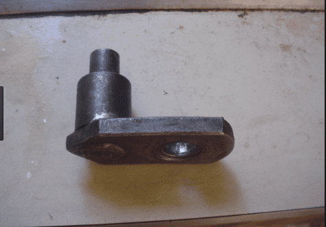

Make sure the Lakewood has the block plate. I'd also say make sure it has the offset pin for a 10-1/2" clutch, but you don't need it with an 11" clutch
Thanks for the link on the pins. I checked my factory bell before but didn’t have to move it.

With the 130 tooth 10.5" flywheel you may need one of these. Not sure they make them anymore? When I needed one it was on back order. Made one, kit came in 3 months later. This holds lower starter hole.
With the 130 tooth 10.5" flywheel you may need one of these. Not sure they make them anymore? When I needed one it was on back order. Made one, kit came in 3 months later. This holds lower starter hole.View attachment 1405076
I’m going to a 143 tooth flywheel so I won’t need it.
If anyone does, I believe Brewers is making them.

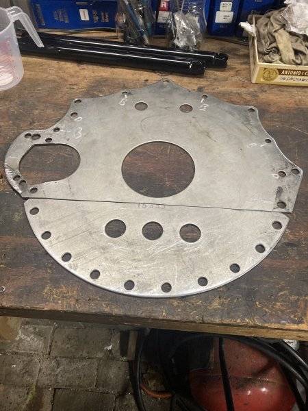

I sectioned the bottom part of the block plate.
Unfortunately, with the upper section on behind the flywheel I can’t install the starter.
I’m thinking of removing the area x-ed out in the photo. It doesn’t look necessary to me and the starter seems to sit in place better without it.
What do you guys think?

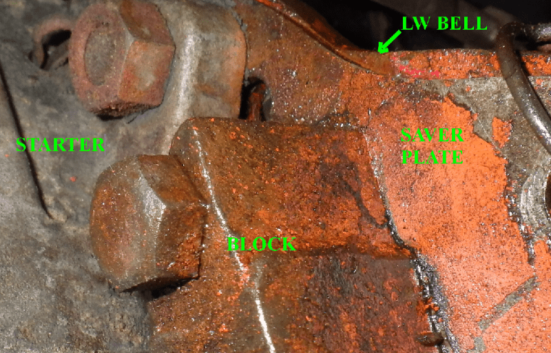

Found a "way back" picture if it helps. Getting in the correct holes was a little tricky as I recall....
The saver plate and bell have the same holes, so I’m not sure the purpose it serves in that area.
The saver moves the bell rearward in relation to the flywheel, doesn't it?
