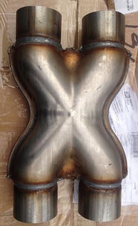

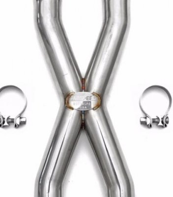

Thanks for the reply. I basically have 2 choices, one where the 2 3" dia. pipes "kiss" with about a 2 3/4" hole joining the 2 together, and the other being more like the MagnaFlow type where there is a moulded X shape to the chamber, but the opening between the 2 is much larger.

Not suprisingly, the manufacturers that make the small common chamber volume say that is the best, while the manufacturers that make the larger volume common area say that gives the best flow....I would still like input from this forum, but unless I am convinced otherwise, it looks like I will be using the larger opening/chamber volume style. Thanks again, I will be checking back for additional posts.
Bump for some weekend readers. Any input? See sample pix Screenshot_2015-06-20-14-06-05-1.jpgScreenshot_2015-06-20-14-08-13-1.jpg](not identical to the ones I am talking about, but close enough)
