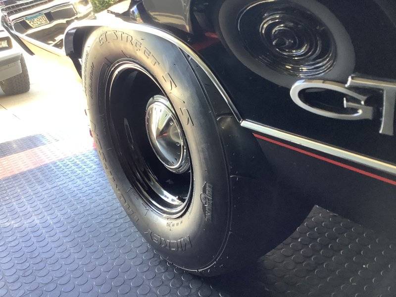

I run 275 60 15 on a 7 inch rim on a 69 bee.
Yup. 15x8 Magnum 500's, 275R60 on a 4.5 backspace:275 60 15 with a 4.5” back space is just the ticket if you want to get away from stock. Carlisle 2018 View attachment 1263094

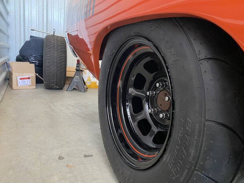

Clearly, it fits on your car (tightly!) because you have the exact correct backspace. Without the dead-on bs, the 295 is not gonna work. I bet the 295 is easier to fit on an 8 1/2 than on a ten. And frankly, I have a couple cars with BIG tires, (back-halfed and tubbed)I think I'd settle for an easy to fit 275 for my rr.15x10 will work with the right offset. The wheels on the yellow GTX have way too little backspace. These are 295/65R15 on a 15x10 which are probably the upper limit without spring relocation and mini tubs…
