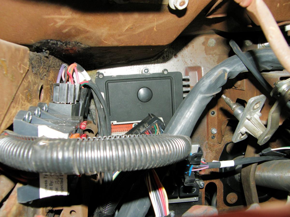

That looks great. You said you are using the 5spd Auto? Were there any tunnel mods that had to be done? What are you using for engine and trans management and wiring? It's going to be a fun car. Congrats....
Rev.
I got an intank pump from Tanks Inc., and machined a plug to fit in the stock tank opening that has the feed and return lines going thru it, I posted a pic of this.The filter/regulatotor is from Street and Performance in Mena Ark., talk to Mark Cambell he can set you up with the needed parts. Or go and get the filter /regulator from Napa for a 99 Vette, I nknow it's not Mopr but it's the cheapest and easiest way to go. I'm using the stock computers, 03 has 1 for engine and 1 for the trans. Wiring Harnes is from Street and Performance, it's plug and play. Tunnel mods Had to be done, no getting around that. Torsion bar crossmember were it rises with the floor pan had to be cut out and a new one that is wider and taller had to be made, 1/4 inch plate bent and rewelded and then boxed did the trick. Transs mount was reworked,pic posted earlier, and I used the poly mounts from Shumacher engine and trans. But the biggest hurdle was engine placement with the 64' k frame,. I dont recall how many time that the engine was in/out, then I realized that you need to use a 66' and up k frame, so the Charger that "donated" the rear also "donated the entire front suspension, bolted in perfectly.
