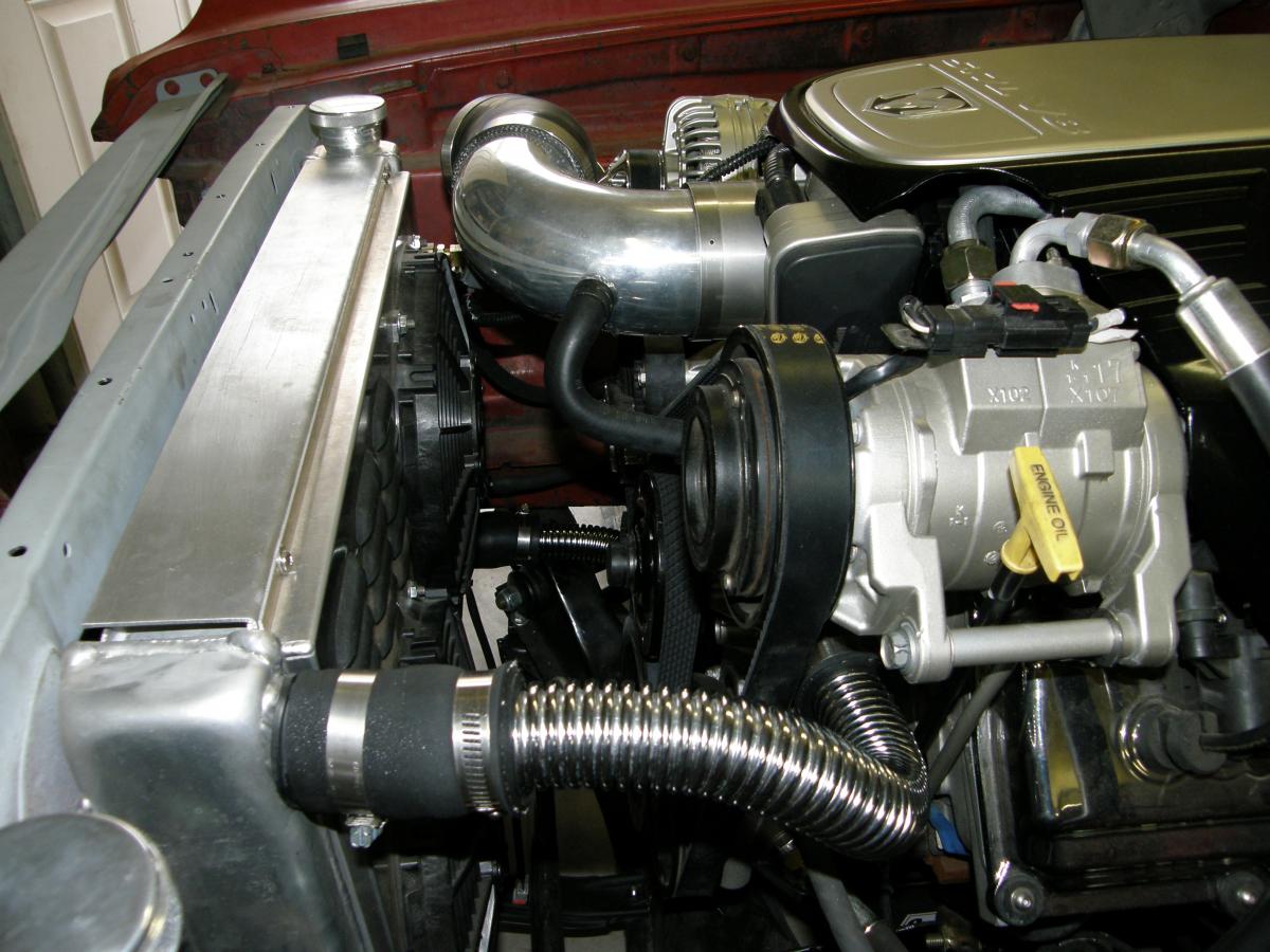

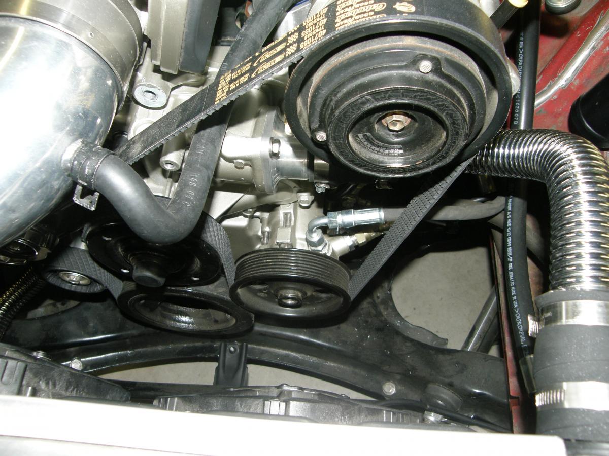

more eye candy

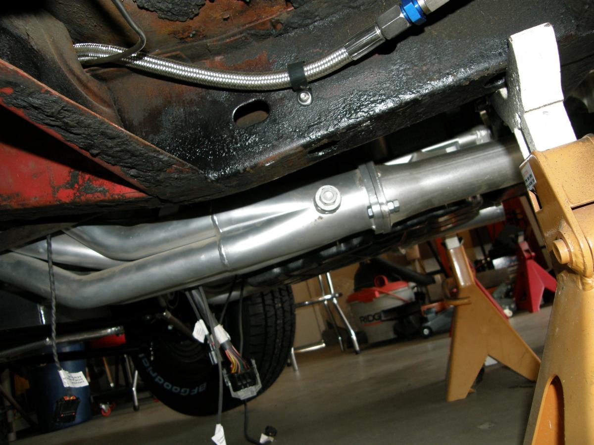

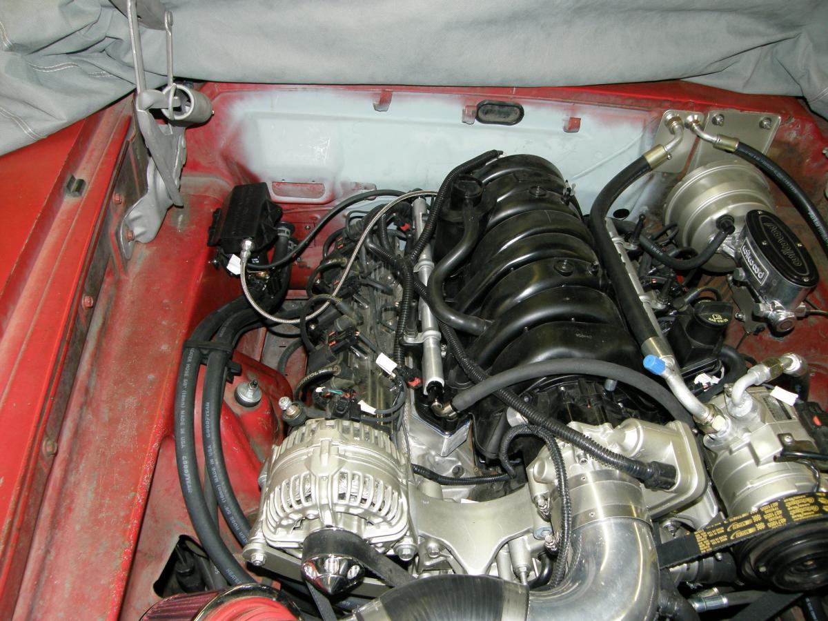

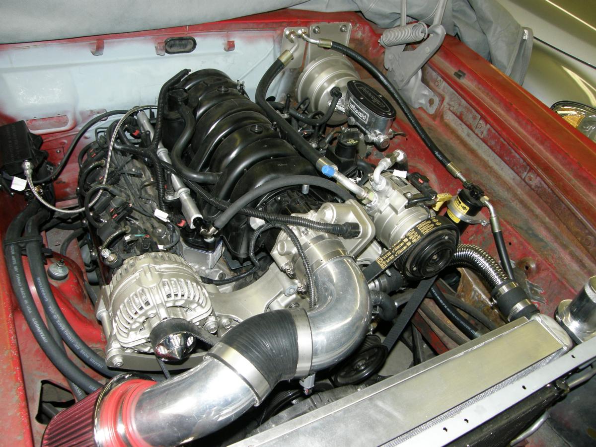

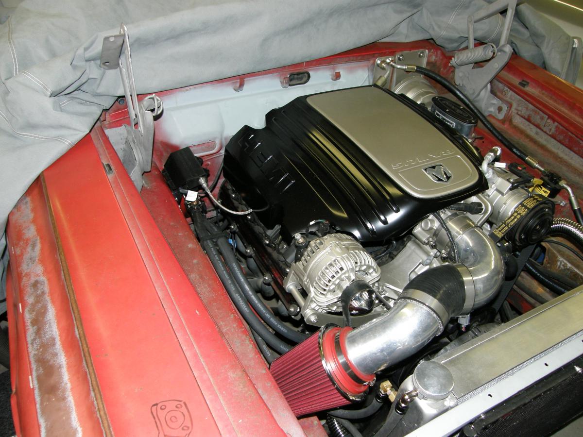

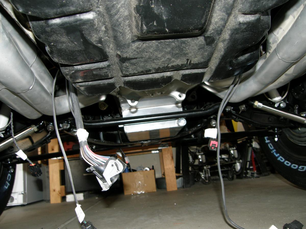

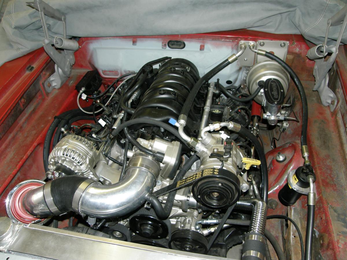

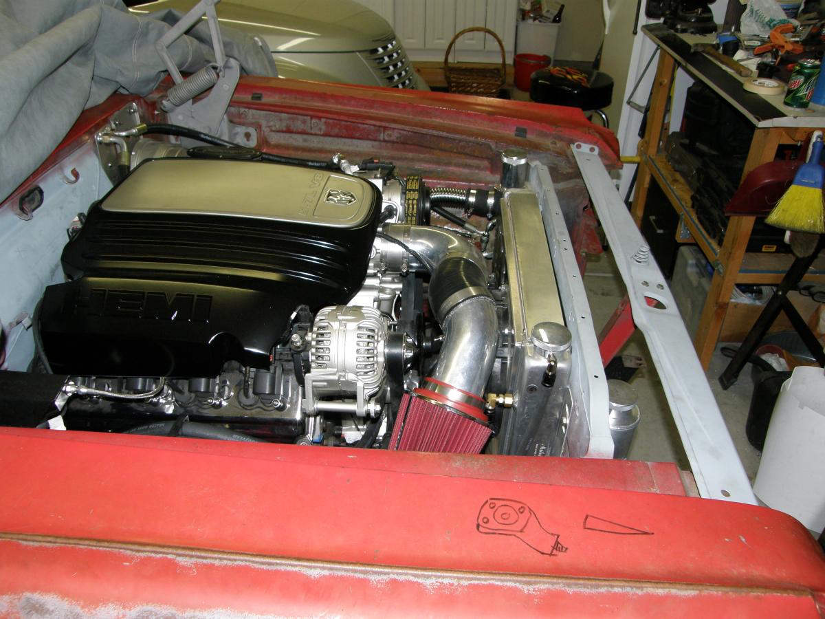

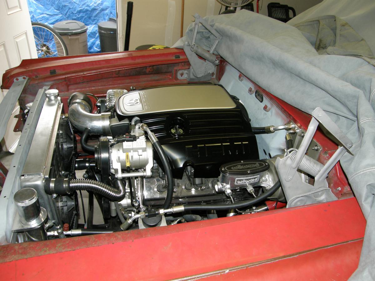

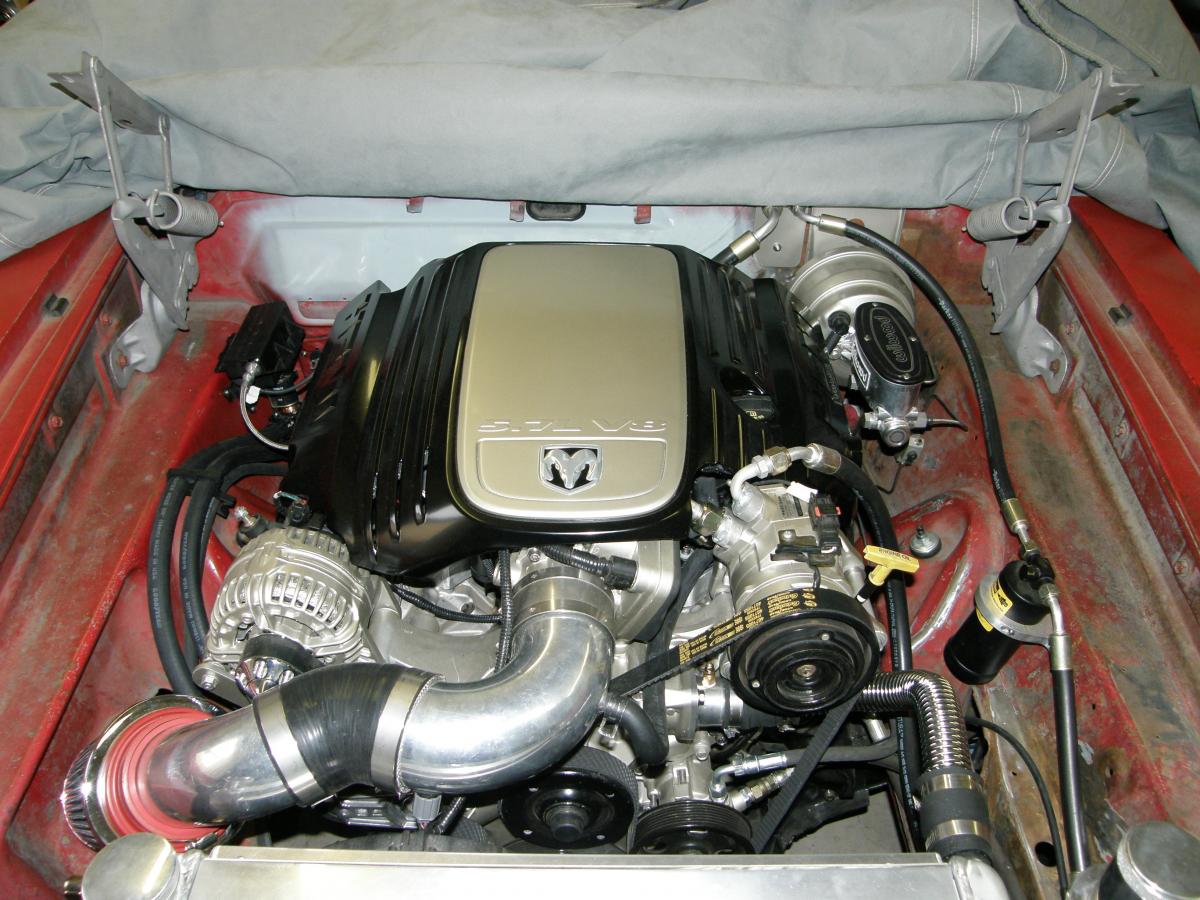

Hi all, I have some new updated pics of how the Carger manifold and custom made manifold spacers look. The bad news is my camera is having difficulties uploading them so just give me some time and I'll get them posted asap. I'm sure there will be alot of questions and I'll do my best to answer them, but I will say this, the kits to do this are real $$$$ so I made my own out of aluminum and cnc'd them to get what I needed for around $80 plus 2 hours of time after work. The best part is if I want to run nitrous, the spacers can be drilled for the fittings and be totally hid from view, unlike the plates that go between the throttle body and intake manifold. While I dont plan on using nitrous, the door is open for someone else that is running an aftermarket fuel system. I'll get the pics posted as soon as my camera starts to cooperate.
As promised, updated pics.

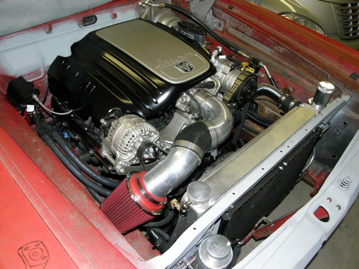

And some more.
Does anyone have questions or coments, good or bad?
