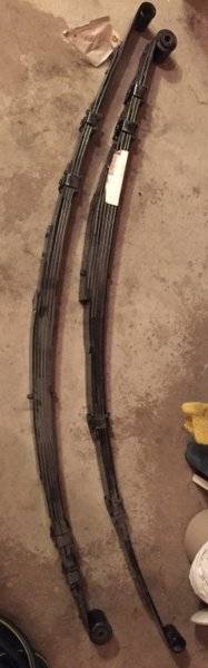

I got these new leaf springs with a 68 Charger I bought.
I am kinda lost as to which leaf set goes on drivers side and which goes to passenger.
Why? Because one leaf set has more leaves in it then the other.
Please advise.
Passenger side should have the stiffer spring.
Some say the the Mopar trend is odd part numbers go on the left side of the car, even numbered parts go on the right. There are exceptions i'm sure, but I think it holds true on the leaf springs. Anyway, the car will torque to the passenger side on acceleration, this is why the taller stiffer springs goes on the passenger side.
Just curious, what brand are those springs? More leafs on passenger side is correct.
