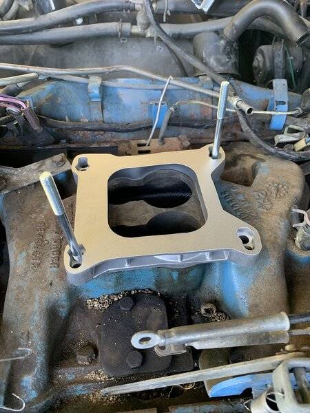

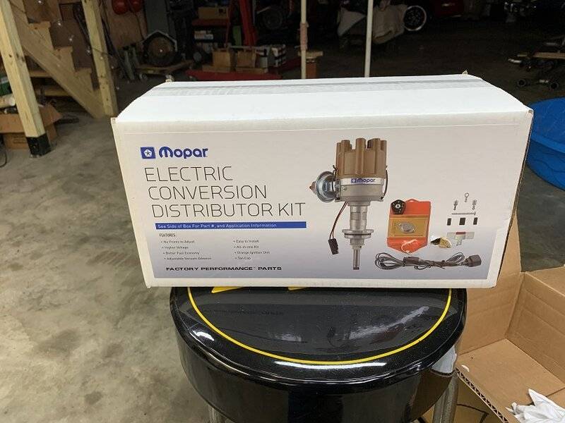

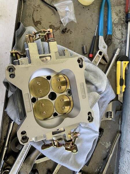

I did my '77 400 summer before last. I used a Mopar performance distributor kit and an edebrock avs2 carburetor. You will need an adapter plate under the carburetor if you run a square bore.

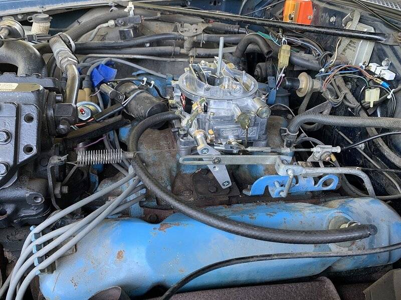

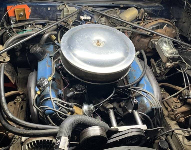

All still good here. this photo shows the latest addition of '71 model HP exhaust manifolds...
Hello, How does the car run? We here did you buy the conversion kit?

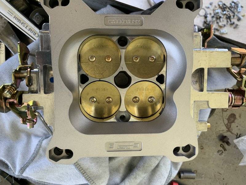

It runs perfect. I bought all the parts from Summit racing,Jegs and amazon. Distributor kit and carb adapter plate shown here. If you need any more info let me know.
