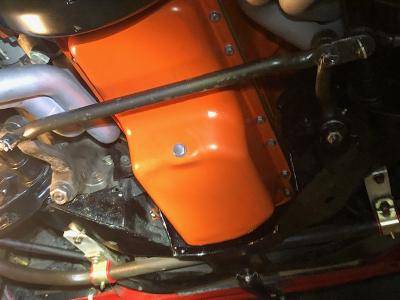

I also have the Fast Ratio arms in my "Jigsaw" Charger and they almost clear with the Hooker 1 7/8" headers. I had to dent them a little!

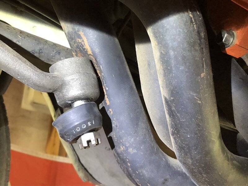

OOOOops....
Maybe, maybe not. The 2" set isn't just 1/8" larger, they have the pipes in a different arrangement. It is best to see if you have more than One inch of clearance with your stock idler and Pitman to your existing headers. The F/R are about 3/4" longer so you'll need that much more room at a minimum.
Thanks I’ll crawl under the car soon and take a look !
