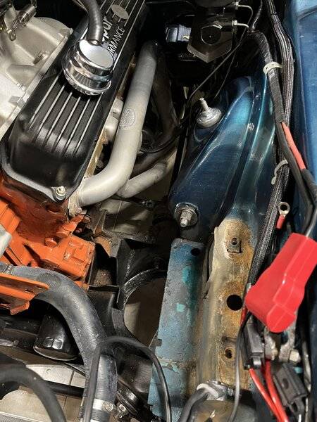

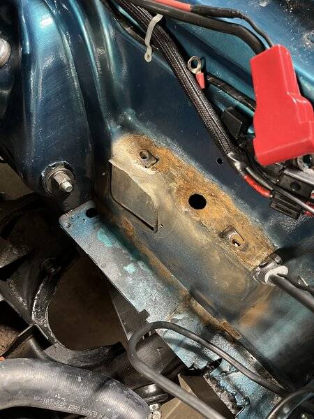

Well I got started yesterday with the removal of my steering gearbox. Will be installing a Borgeson box I bought from Bergman Autocraft. Got his modified column coupler, and the necessary fittings to hook up the hoses.
I thought I would list some of the removal process, in case someone has a similar set up to mine. Maybe help someone who might be thinking of this.
I chose the Bergman/Borgeson because of weight, size, turning radius, and steering feel. It was not the least $, which I quickly realized was a bad choice for me. I like to drive interstate speeds, and wanted the security of what this combination offers.
I had a helper who did the “ heavy lifting “, we started about 9, and had the old box out and we’re picking up tools and cleaning up by 1. The new box is not in yet, I will be degreasing, cleaning and painting now that the old one is out. And installing a new wiring harness to my mini starter.

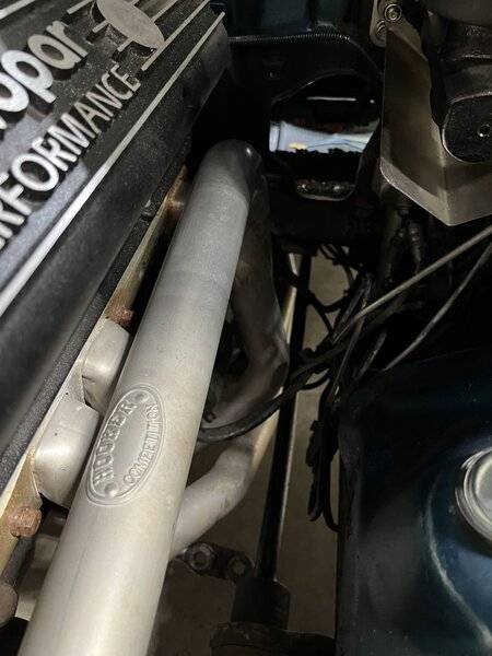

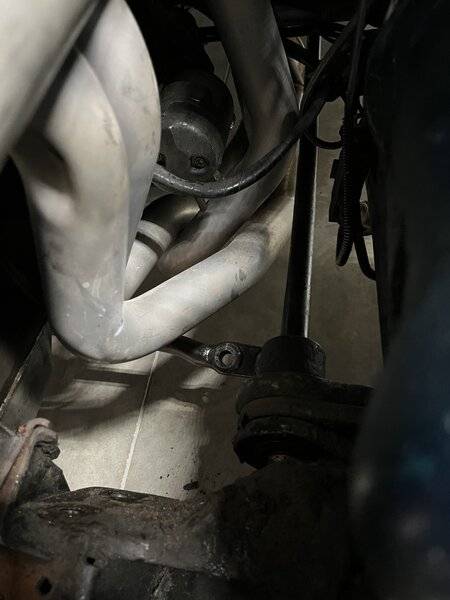

We were able to remove the battery and tray, and PS pump with bracket. Pulled the 2 long thru bolts on each motor mount, jacked the engine up with a wood block on the oil pan. Of course the car was on a small frame lift which raised it about a foot. The old box rolled out the front without touching my hooker competition headers !

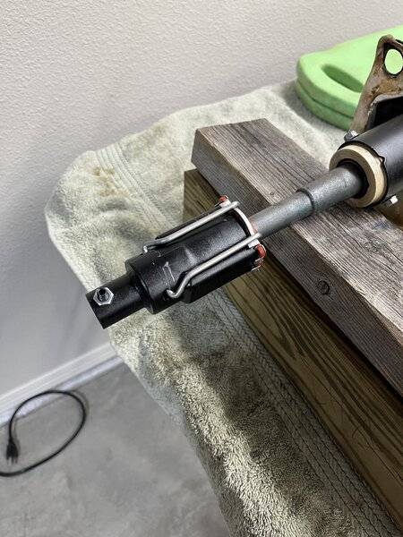

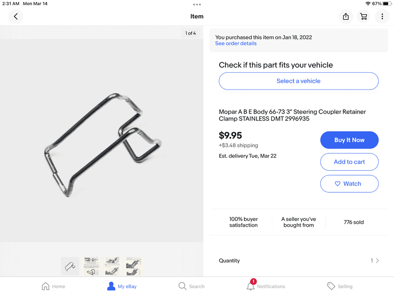

The spring clip in the pic of the column is one I got off eBay. It is a very positive way of holding the seal on the top of the steering coupling.
I noticed that and love it! Can you please provide a link or description so we can search and order our own?
It is a serious retainer indeed, i think it also assists in overall chassis strength once installed in the car. :)

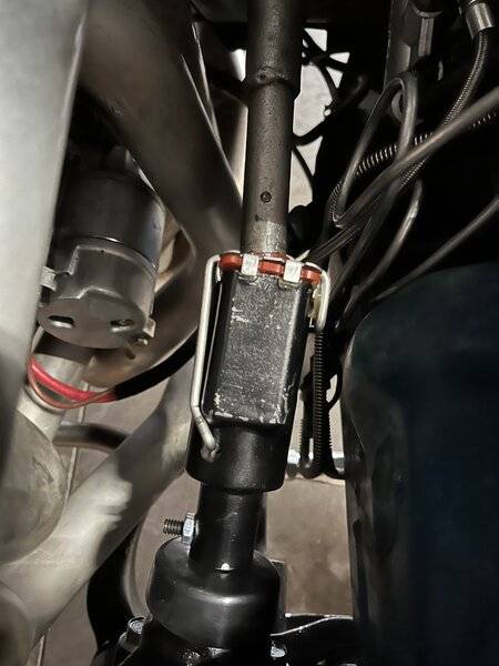

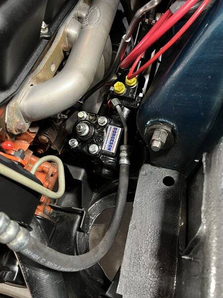

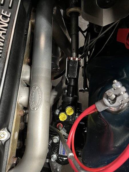

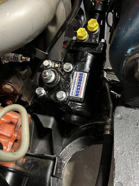

Thought I would post some pics of the Borgeson/Bergman steering box/ coupler install. Not quite finished, but the “heavy lifting” is done.
Didn’t have to raise the motor , the new box rolled. Right in place, even with headers. Of course the battery and tray were removed. It was challenging to get the coupler on the box, and it is at an angle that I wish were much less ! But Bergman describes this in his instructions. Have not bled the system or started the car yet. The new box is smaller than the OE, and you can feel the “stiffness/resistance” in the steering wheel when you have it centered and straight ahead. I’m anxious to test it out !
1BA320A2-84D8-42E8-816E-B221D4D3EB09.jpeg 3F9E9891-A5A9-4A19-BAC4-DA79E4C18E0E.jpeg E7593067-DE23-4E94-AB0C-B679DD65B763.jpeg 4A1FCFD1-180F-4C23-BB1A-9D32D79587D3.jpeg
Looking good, though that angle in the steering coupler looks odd to me but hey, if they already described that that will happen and they deem it good...who cares.
The OEM type coupler is also able to work under angles is it should be no problem, but I think I will go for the Borgeson coupler anyway.
How did you remove the old steering box?
When I replaced mine I had to go from below as it would not come out from the top/front.
But since then I also replaced the headers with TTI from which the tubes run a bit different, my old header was similar like yours with#1 cylinder going over the top.
Think I will go for lowering the K-member while slightly lifting the engine, need to replace the torsion bars also so I can combine the job.
I can understand, really interesting how it works out! Keep us posted!

I described the removal process on my March 12 post. I emailed Bergman about the coupler angle and he said that was perfectly acceptable. I used the Bergman coupler mostly because I didn’t want to cut my steering shaft to accommodate the Borgeson u joint. I have a power steering cooler, but have not mounted it yet. Mr Bergman says it’s not really needed. My cruise rpm at 70 mph is about 2100 rpm, so the ps pump is not spinning too fast most of the time.

I got the steering all buttoned up and took a short test drive today. WOW it drives like a new car. Great on center feel, and still good assist. Money well spent. Texted Mr Bergman with a couple of questions as I installed. His answers were very fast and helpful. Great customer service. I’m happy I spent the extra $ over a rebuild of the old box !
