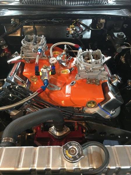

A&A intake on trickflow 270's with 3705 carbs,,,fuel injection like throttle response. food for thought. with the intake raised appx 1" above the block eliminates alot of the typical crossram installation headaches...without air cleaners the hood would close .
While that look is undeniably Mopar Gold, and I love it….. I don’t currently have the $$$ for it, and I’m willing to bet the car would be faster with my single 4150 on any good single plane (debatable).

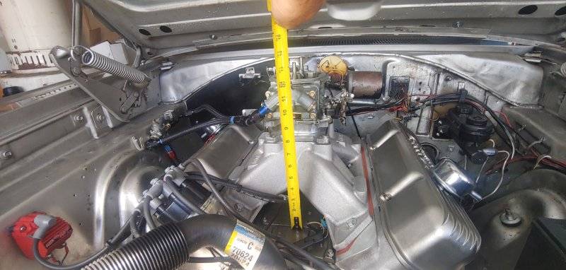

My Indy Max Wedge seems to work great on my Indy heads. I bet it would be good on the 270TF's. It is pretty tall. I had to do a lot to get under my hood with a tall
'66 HEMI scoop.
