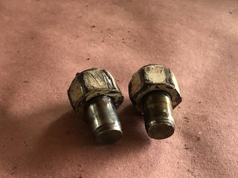

Or do what anyone with a welder would do...Weld a lug nut onto it and crank on it back and forth until it comes out.

Weld an allen bolt to the dowel. Slide a socket and washer and nut over the allen threads. Tighten the nut and they will pull right out. I did it right in the car.
