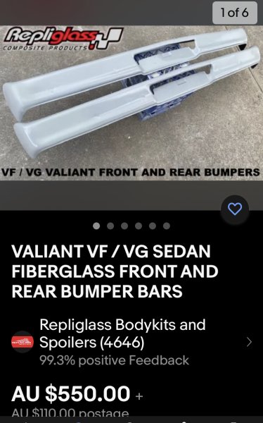

Do you have a local source for glass parts down under? I'm sure there is no one here in this country making parts for your car.

Yep, have a guy that does the bumpers and another that will do the hood , ordering them now .
