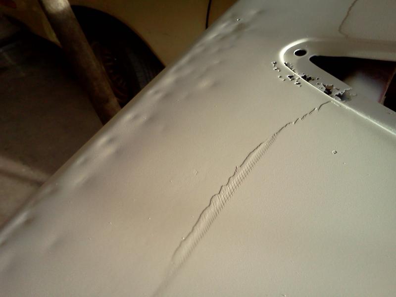

I've never used Bondo before.
I'll be attempting to fill several small dents in a non-rusted area of a hood, and then I'll be patching some rust holes with new metal, and will probably need a skim coat to even up the patches.
What's the diference between the following products?
"Regular" Bondo
Bondo Professional Gold
Bondo Professional Gold Premium
Would either of them be a better choice for a first time attempt?

I saw two nickel sized rust holes and one quarter sized hole (under the lip).
When I started sanding/blasting I found those dents covered by a 1/8 coat about a foot square.
(and found that rust under the fake air inlet trim)

Nowadays, there are other choices to lead, and I wasn't saying no bodyfill on the hood , only main filling should be lead or glass... Hoods flex. Same as quarter joints. I am happy for the guy that had bondo across his hood, that it didn't crack. I know how I was trained, I just figured I d share. Btw, first I would hammer and dolly those dents, why fill. Or zap some studs to pull them. But don't leave them.
I'm kind of stumped as to what may have caused those.
At first I though they might have been high spots that someone hammered down.
It almost looks like hail damage, but why only a small area?
That's what I think, somebody went to town with a body pick. You can definately work those lows up some.
