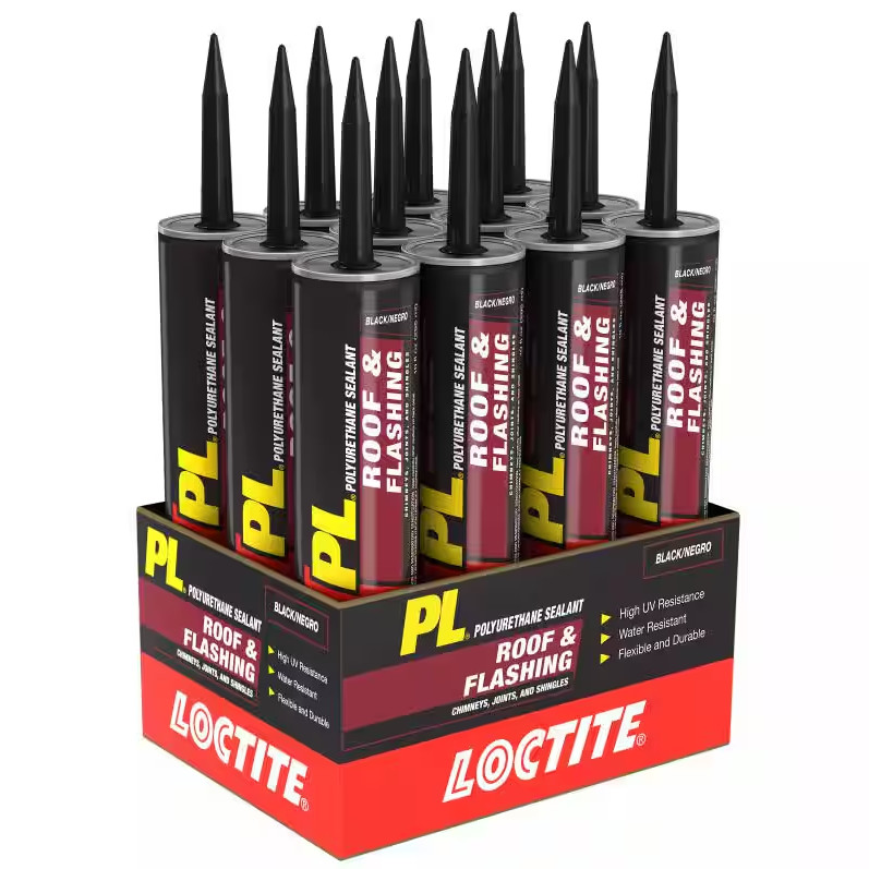

Melt it on out with a heat gun and re-pot it with this.
http://www.homedepot.com/catalog/productImages/1000/3b/3b1a9cc2-2fce-4eae-898f-22f38190e4e1_1000.jpg
I've got a box of old junkyard OEM MOPAR 5 pins I'm going to do that to.
