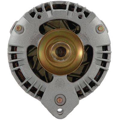

The older "roundback" alternators do not put out nearly as well at lower RPM as the newer "squareback" type. You might consider asking for a 45-55 or so and make SURE it is a squareback. This will have TWO field terminals, so to hook this to your old 69/ earlier regulator, you'll need to ground either one of the two field connectors
You can also, of course, add just one wire, and convert to the 70/ later regulator.
example of a "squareback"

PS: I've got a "round back" and a "square back" and I think I'm running the "square back" on my 70 Bee.

So is this the 70/ later isolated field type, and do you have a squareback alternator? How large (amperage) is the alternator?
