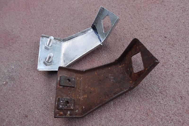

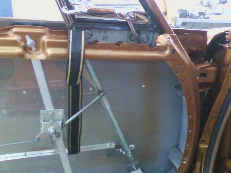

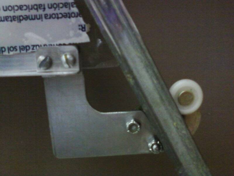

Too refreshen, it's not only the small fasteners themselves that make a difference, but the small things held on or supported by the fasteners that help trim those pounds. Here's a pre-finished door window track bracket. Under the radar, but nevertheless...........Less.
Too refreshen, it's not only the small fasteners themselves that make a difference, but the small things held on or supported by the fasteners that help trim those pounds. Here's a pre-finished door window track bracket. Under the radar, but nevertheless...........Less.View attachment 1226948

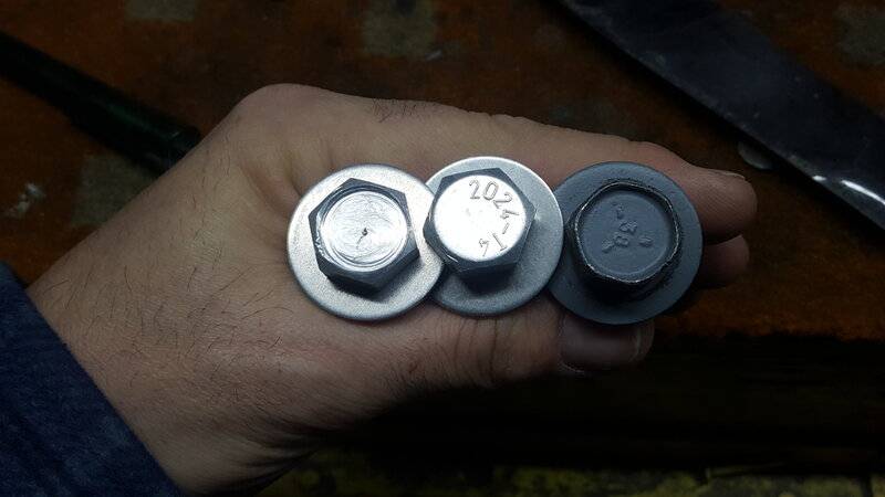

What some people will do to achieve a goal. Trust me, this is not me, but a friend that is trying to have the look of stock fasteners. Here is an UNFINISHED version that when it's completed will fool the untrained eye unless you're a concours show judge.

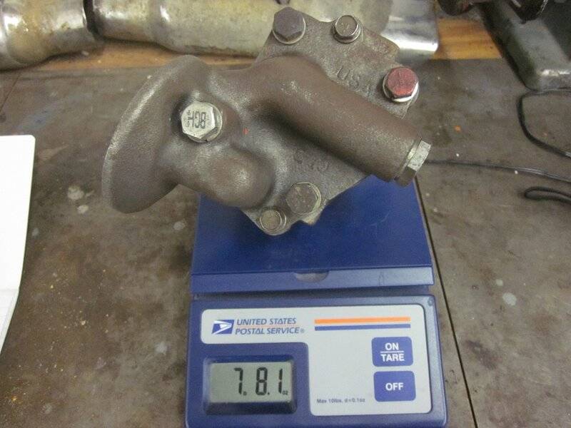

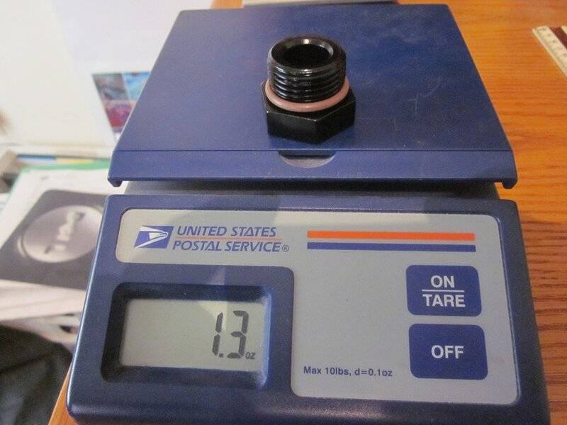

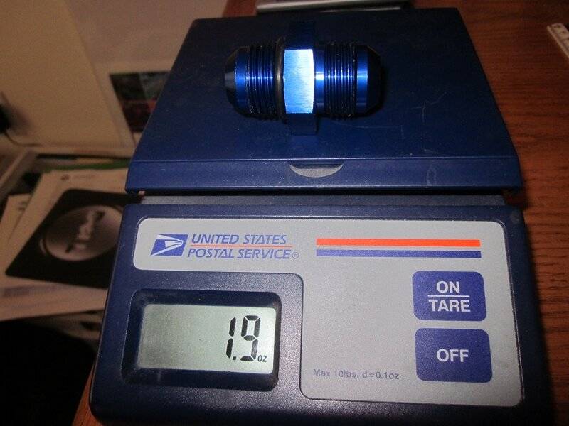

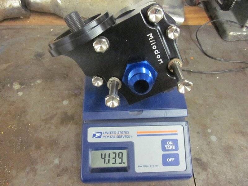

Hi Lee ( fullmetaljacket ),
Nice to find you here!
I am still at the weight loss program!
My latest item was switching from a Melling oil pump shown in the first picture at 7lbs 8oz
to a Milodon pump and cover with Titanium hardware shown in the second picture at 4lbs 13.9oz.
I also swapped the union fitting 1.9oz for a plug at 1.3oz for a total loss of 2lbs 10.7oz.
In addition the Milodon pump takes less HP to turn and has better pressure!
We ran the pump last weekend at the INDY bracket race and made it to the 5th round!
MJ
MJ

Love it all the way Mopar John. I love that you micro document all of your changes. I was thinking way back about a Milodon as well, but since I have an internal pickup, (my stroke is modestly small) I figured why give away anymore hints and stayed stock. I did install the correct length titanium bolts to hold it all together. Glad your's worked out. My next engine overhaul will be having a Milodon for sure.

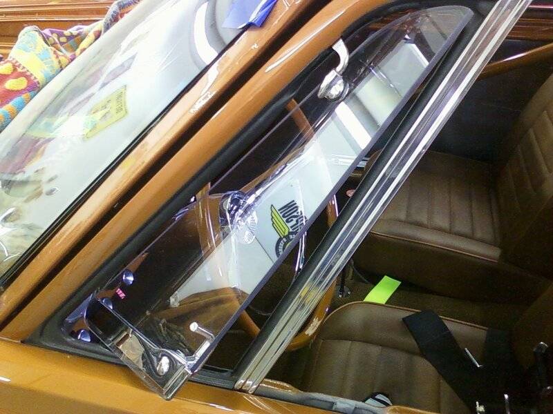

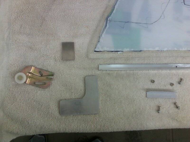

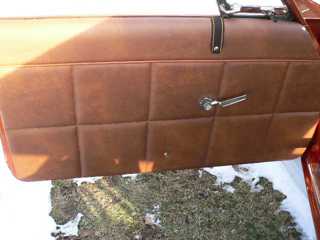

I took FMJ's light window mounting a step further. Its amazing what you can do with a Home Depot closet door roller. Yes the vent is also Lexan.
Doug

You know I bought the pump a while back.
I was worried about installing it!
The first problem I had was plugging the external line port and using a stock pickup!
Then there were 2 pages of instructions with may cautions about clearances and shafts.
I finally took the time during a pre season oil change to install it.
So there is the weight savings to start with.
I have noticed a 3 to 5 PSI increase in oil pressure when cold at idle.
I have also noticed the oil pressure doesn't fall off as much when HOT after a pass!
Then there is the fact that it uses less power to operate!
I wish I had installed it when I bought it!
MJ
Doug
Is the Lexan the same thickness as the original glass? Made a driver's door glass from 1/8" Lexan and used the original tracks/guides and well, it worked but not as smooth as the original glass did.
First off, regular tempered pane glass is much harder than Lexan so it will glide on any surface whereas Lexan though being more flexible and much lighter, tends to drag just a little bit but almost unnoticeable. The glass can be 1/8 thick and stock is 3/16 thick or so. A little soap bar rubbed on the tracks or the glass itself will help make it glide.
It is 1/8". The window drops easily when unsnapped. When pulling it up you need to put your finger at the top rear corner. Easy enough. But not perfect. If I did it again, I'd use 3/16" for the door windows. The vent windows are original thickness.

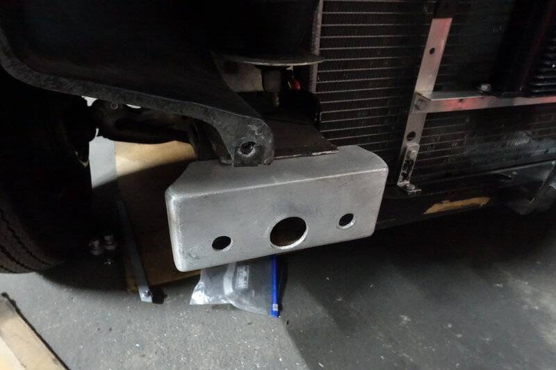

Though this thread is on lightweight fasteners, here's a part that in someway, has to do with bolts and nuts. This trick saved about 2 Lbs total between both sides and now fastened by lightweight bolts and nuts. Painted black with the rest of the chassis and it isn't there.
That's very cool. I'd be using body-panel adhesive in places like that.
