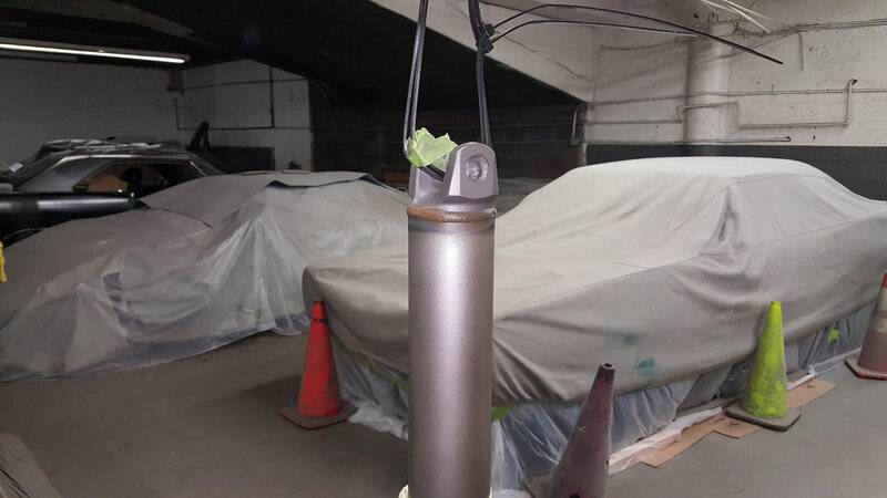

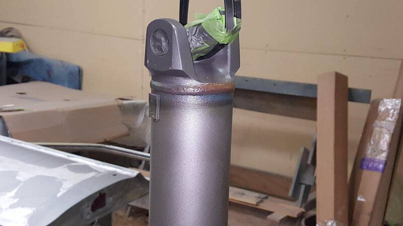

Here's the best flicks I could muster up of the STOCK STEEL driveshaft. LOL. By the way, that's my aluminum door in the background of the second picture. OOOhhps, did I let that one out? LOL.
Here's the best flicks I could muster up of the STOCK STEEL driveshaft. LOLView attachment 1224610View attachment 1224611

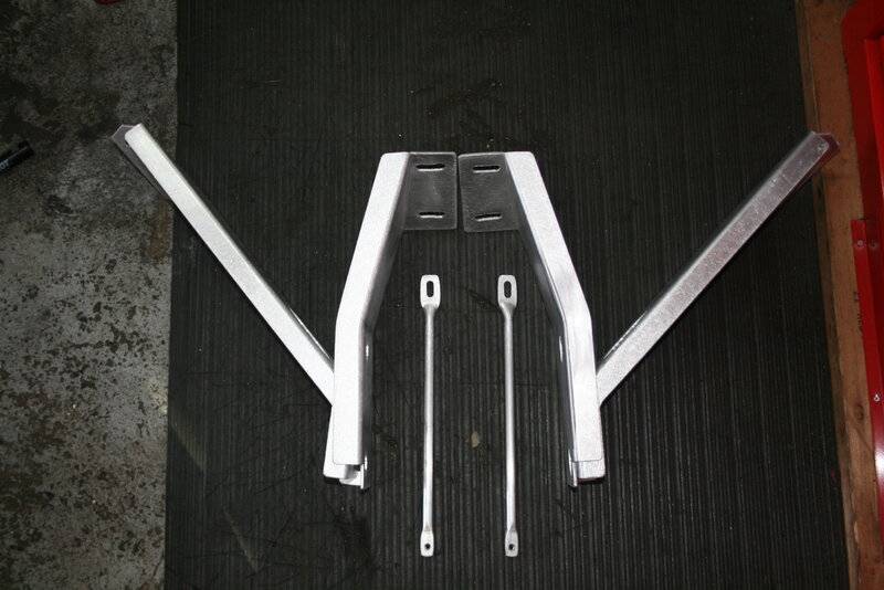

I did not make these front bumper brackets myself but they are on my Duster. The guy that made them is a fabricator by trade out in Michigan. He has an 8 second, small block turbo '72 Duster called Fool's Gold. He made two sets and I was lucky enough to get the extra ones.
Frankly I don't remember exactly what the weight difference was over the stock ones but it was significant. The other benefit of these is that they're on the front of the car. And speaking of lightweight fasteners, I'm sure fmj would know better than me but perhaps there are aluminum bumper bolts out there somewhere that could be polished up to look like chrome.
In any event, the same ideas would apply to any B body. If there was a concern about them standing out you could just paint them up and to make them look like the originals.
Indeed.

For the record, back in 2003 or so, I created an exact replica pair of bumper brackets for a friend of mine that runs a fast real street Duster and they were significantly lighter than the originals. Even survived a 45% hit when he hit the wall one day. Agreed that the weight up front must get its eviction papers sooner than later if rapid acceleration is the objective.
There are a variety of carriage bolt sizes out on the market in aluminum that could be sanded, rubbed and polished to look exactly like chrome. Though a stock bumper itself is obviously heavier than an aluminum or fiberglass version, these carriage bolts seem to be somewhat strong and capable of carrying sheer weight if it is not too heavy. But then again, why would anyone change only the carriage bolts and not the heavy elephant in the room?
Again, not to seem like showboating, those carriage bolts held my stock bumper on for years until I retired them when a new lightweight bumper was on the horizon. Keep in mind that some stock bumpers from car to car/ makes and models are different in weight. My '65 bumper in bone stock trim was relatively light at approximately 22 LBS. Where as my friends '64 Dodge bumper with all its curves and compound bends was a porky 33-36 LBS more or less. My current lightweight (steel) bumper comes in at a feathery 8 LBS, so those carriage bolts would not be even acknowledging its presence.

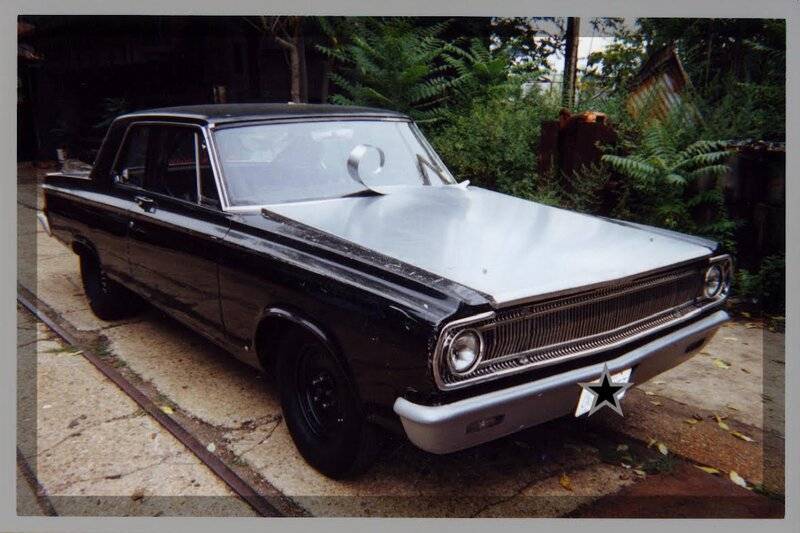

What's the story on the light weight, steel bumper @ 8 pounds?
Thin gauge 341 stainless steel center section break formed over metal shop table edge with the original bumpers end caps tig welded on the ends. This since those compound curves that shape the caps were hard to form on hardened stainless steel and I didn't necessarily have all the right tools handy or any access to an English wheel at the time.
I then cut and shaped the running light openings to mimic the originals, but I was never happy with them, because for some odd reason, I couldn't get the openings rolled or flared in like I wanted and they looked too fake and fiberglassy to me, so I settled for sharp looking edges that I did with a Dremel. After all was grounded down and very thinly spot puttied and finished, it was painted aluminum color using a spray bomb funny enough.
This image below is from way back in 2002 or so at the Brooklyn Navy Yard. Note the front bumper already long been installed using aluminum carriage bolts. Also here is the aluminum hood itself in the midst of having its first outer skin perimeter shavings and fittings done before a visit to an English wheel and power hammer at a nearby metal shop. That was a crazy project all on its own.
Talk about history, this here is a stones throw away from the dry-dock where both the USS Arizona and USS Missouri were constructed. Both the start and end caps of WW11. Almost 60 years later, a lightweight was being constructed in its shadows.
