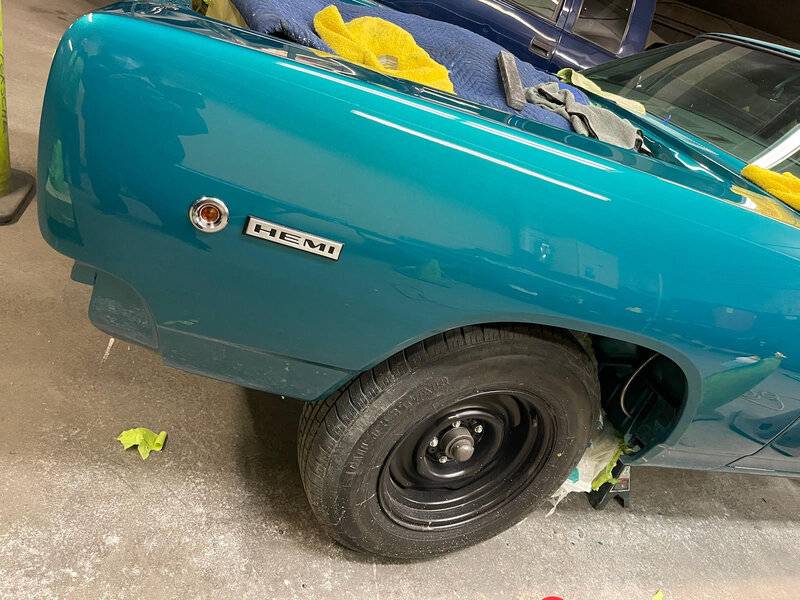

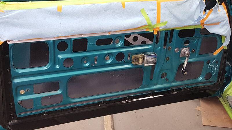

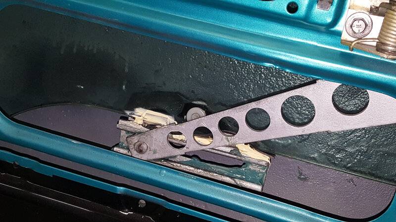

Takes a bit of work but it's worth it imo. Got my 66 Belvedere I down to 2950 with only the hood being glass and no front bumper. Yeah, it was a /6 car but it still had the factory AC on it. Now it has a well trimmed K-frame, lightened door hinges (lightened by 40%) and several other mods. Now all I have to do is put the thing back together.I envy all you light weights. Mine is 3760 with me in it. MEGA block Hemi, All steel, all glass windows, full interior, 25.5 cage, with full tank, both bottles, fire suppression system and cool suit cooler filled with ice and water.
