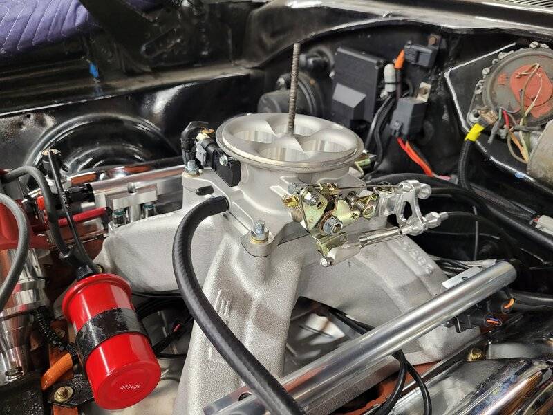

I installed a Lokar throttle cable, bracket and kickdown cable on a friends Edelbrock PF-4 install and REALLY liked it, even though I didn't want to...
I used my stock linkage, 383 2bbl, on my Edelbrock RPM w Fitech FI. Used a piece of allthread that matched the vertical adjusting rod and horizontal rod, turnbuckle to connect. Used a bracket from Mancini to adjust for hight on rear of manifold. I prefer the stock mechanical linkage. That said, I have heard good things about Lokar setup. Have a look at this video. I did this and my throttle and kickdown work perfectly in sync.
