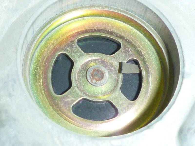

There's no way a car should need 20 seconds, nevermind 10 seconds to start. When I did tune-ups back in the garage way back, a customers car was expected to start within seconds. In the purpose of this thread, as an example, my 318 Doba will start immeidately. A week later.... crank till the cows come home.
And I've said it a dozen times here, there are other reasons for dry fuel lines...
