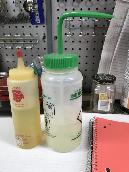

Carburetors have vented fuel bowls and today’s fuel compared to that of 1970 is highly volatile and evaporates quickly. That low volatility also promotes fuel percolation after a hot stop and heat soak so after driving your car a good portion of the fuel in the fuel bowl is gone within a half hour - but not enough to prevent a re-start. However more evaporates out each day until the level is so low that after awhile you have a nearly dry carb. People experience different severity of this issue due to some carb model differences, different fuel formulations around the country and times of the year, and some use racing fuel with a lower volatility. I usually prime my carbs using these if I haven’t driven them for a few days.
On Holleys and AFBs I fill the bowl directly through the bowl vent, primarily the bowl that feeds the accelerator pump. When I first see fuel dribbling out the venturis I know the bowls are full plus some. I get in the car, pump the accelerator 2-3 times, wait a few seconds and the car starts on the first revolution of the motor.
Spinning the starter without touching the pedal for 10 +/- seconds, pump the throttle 3 or 4 times, wait a few seconds for the fuel to vaporize a bit and then turn the key is an alternative. But one 10 second burst of spinning the starter seldom does it. You may have to spin it foe 10 seconds 2 or 3 times to get enough fuel up there. Just me but I don’t like to spin a cold engine that much and put that much work on the starter.
